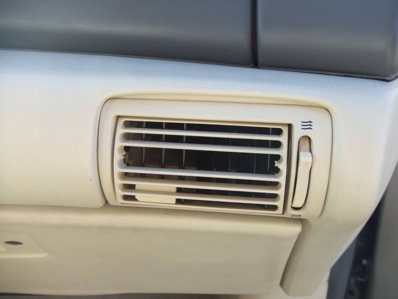

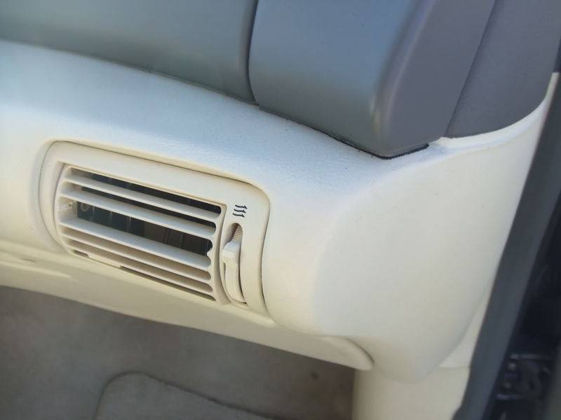

last night one of my friends got out of my car, and on the way out he kneed my air vent On accident. so now i have to replace it. anyone know how i can get the peice out. and where i can get the parts. i think this vent is popular ive seen it in the Taurus and others. please help... it bugs the :q:q:q:q out of me.

also would you happen to know the name of the part?
On car-part, I would search dash. Odds are if the dash is there, so is the vent, but I almost guarantee the dash will have to be pulled on both cars. PITA for sure.
AH, its called a RH AC register
also to get it out. all you have to do is open the glove box, and remove 2 screws.
I may have one. I'll have to look when I get home. Put a flat blade screwdriver against the right side of the vent and the housing. Lightly pry toward the driver's side of the car and it fall right out. To install, it just snaps in. Or the whole housing comes out with two phillips screws. Open the glove compartment, look up and you will see the screws. You can take the one from the drivers side. They are interchangeable.

find the broken peice and use some super glue..Just be very conservative when adding it..I had to do it when 1 of mine broke..Can't even tell unless you go right up to it... No need to waste 10-20 bucks for one..
I would rather spend $20 now then $50 buck's later trying to find one to match my color. or get one panted to match... just my thoughts on the matter.
