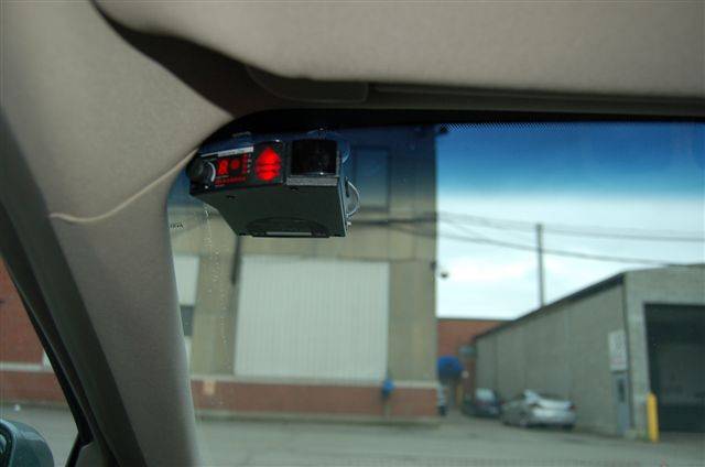

I wired mine off the mirror which is a switched positive and ran the wire under the headliner to the corner and down under the dash to the V1 phone jack power module.
The negative is just hooked to a screw thats grounded.
Then I ran the phone wire power cord back up to the V1.
Made some custom brackets to attach to the suction cups at different levels so it would be horizontal on the curved glass.

Great Set Up! I'm going to have to seriously look into hard wiring it. Mines suctioned in the middle of my dash under the rear view. I'm a bit concerned about if it's enough of a clear view out the back window. I"ll have to try L mode tomorrow, I've been on All Bogey since I got it
I have no problem picking up cops from behind and it's also practically invisible to thieves. Cops won't see it even if they stick their head in your car.
It even sees around corners and over hills.
I took over 2 hours mounting mine, put the receiver as high on windscreen as possible between the drivers visor and the mirror, when the big visor is up (stowed), it has a clear view back (the rear antenna) and with it down, you can't see the detector at all, even from the drivers seat. The Remote display is next to the drivers door, just below the headlight switch so a uniform looking into the car from either window can't see either unit or a power cord. The power cable is tucked into the headliner and the A pillar.

I tried puttin mine up high and it noticeable reduced radar pickup from behind since it lost line of sight and from the front too because of the tint strip.
