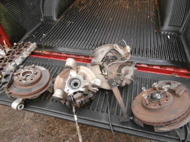

I bought mine pre-assembled off a wrecked M8: 4.5'' hubs with front splines and rear knuckles. It looks like just the rear hubs were re-drilled, but all 4 rotors were were re-bored with new holes for the 4.5'' pattern
seems strange that the previous owner would rebore that front M8 rotor, but maybe that was the best choice
