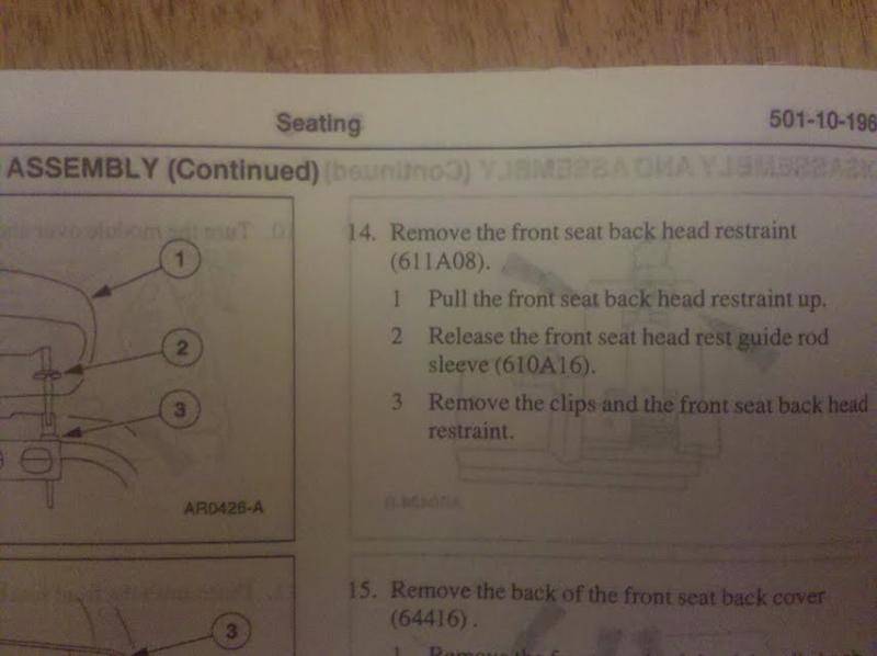

I thought I would go ahead and switch my seat backs but need to swap the covers first. My first snag is the fact I have no idea how the dang head rest comes off. :lol: I thought they would just pull out but no luck. :(
IIRC, There are some clips on the inside that need to come off. They're like c-clips. Only way I know of to get them off is to reach up the inside of the cover, but by then you may as well swap out the cover too.
hope this helps
Thanks guys, found the clips deep inside the leather. Popped out no problem and then I pulled the cover off. Repaired the foam some too.
