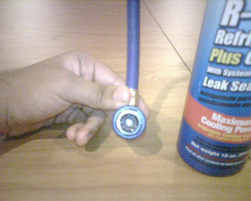

can you explain better what you bought? or show pic.
it should only be able to plug into 1 of the ports (the low side) it "should" also have a blue colored cap on it. if the guage wasnt reading, its a bad guage or it just wasnt pluged in corectly.
ok this is it, sorry the quality sucks.
BTW Am I suppose to take the rubber piece out? It was on the top but It pushed down since I applied pressure
you have to pull up on that blue part, then push it on to the low port.

the blue ring right near where it goes on low side port, as you push it onto port you need to pull the blue part back to get it on all the way,then release it to lock on,

I went To pepboys and looked at the others and found that the part was defective. They exchanged it for me and it fit on the low side perfectly. I started my car and put it on auto 60 degrees and the gauge was reading in the Alert level.

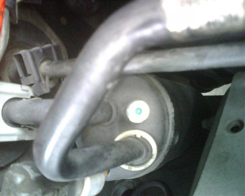

second answer, and i am NOT a ac expert, (boss man wants me to learn lol) but it could be a plugged orface tube maybe a bad reviever dryer (big black can your hooking on to)
Exactly. High pressure is not good and means something is very wrong - or the gauge is screwed up! Releasing pressure is not going to help.
also the low put has NO valve core in it. at all, just a little green ball. maybee he will post a pic of it. my 95 has a valve core, but his 93 just has this little green ball.
