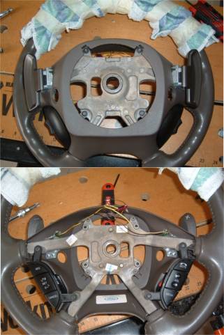

I installed a steering wheel with paddle shifters on my BMW (had to modify the airbag...). I actually prefer them to the console shifter (which I could also use) as I can keep my hands on the wheel. It also helped that I got a steal on the wheel out of Lithuania.
yes, I can understand wheel mounted switches a lot more than the shifter based versions for the same reason. much safer to be able to click down a gear in the middle of a turn without having to move your hands vs reaching down to click through them...
I always wanted to do the paddle shifter mod but after talking to Lou a could of times about the wiring "around" the clock spring, just wasn't worth the trouble
Didn't Lou mount the shifters on the column, not the wheel?? Wouldn't need to worry about the clockspring.
I've seen the column idea thrown around. Some people prefer that because it's easier to keep track of the +/- location.
As for the wiring problem, I haven't had a good solution for that. I was thinking maybe run a coiled phone wire wrapped around the steering shaft. Get fancy with phone jacks and you can make it easy to replace the wire when it fails. But, can I actually get past the clockspring? I don't know, I forgot to look
no they were mounted to the back side o the steering wheel
