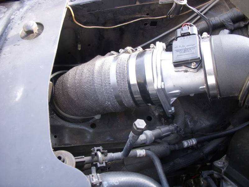

I also had a large 9" long Cone filter. Top of the filer almost rested on the bottom of the bumper. where it was sucking real cold air.
I used a 90 degree bend rubber tub you can get at any Home Depot. If you want you can use thermosleeve to help keep the heat out...
