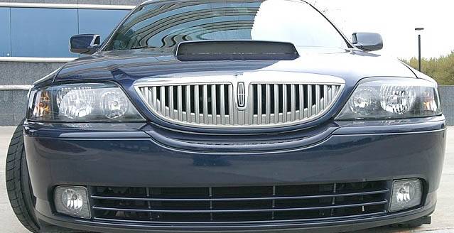

He doesn't have a hood scoop, more of a ram air intake. There was a post a while back with some *stolen* pics from LLSOC.
http://www.lincolnvscadillac.com/showthread.php?t=626&highlight=hood+scoop
That's what i'm talking about. Thanks i just wanted to see it on a car. I mean i just bought that cold air intake from LSK, and the hood scoop can do nothing but help your engine breathe better correct? Not to mention i do like the looks of it.

correct - most of these scoops are not functional becasue they actually do not line up with the air intake (so no ram efffect) and would let water into the engine bay.
the right one would look ok - but make it a functional one.
Remember, most of the time while your car is in motion, your intake will be ingesting air that's moving through the front of the car if you have an aftermarket setup. Adding just a hood scoop will do nor more for cooling the intake charge when the car is moving... it's basicly the same air. And when your car is idling, it's just slurping up the war underhood air anyways. Ideally, you'd want to move the point of intake into the fender, below the engine bay, or have the scoop (like Lou) port air directly into the filter box. Other than that, it's just cosmetic.
Although, that ain't a bad thing either. I think a couple of Trans-Am syle tunnels on the hood would be sweet. Just remember you have to deal with the center indentations in the hood.
Sorry, I didn't mean to suggest you vent your fenders. If you relocate your air filter (like a K&N cone filter or the KKM intake) into the fender or under the engine bay, it's a better source of high pressure cold air, isolated from the fender. If you vent or cut anything, it'll still allow water to get to your filter and you risk hydrolocking your motor.
