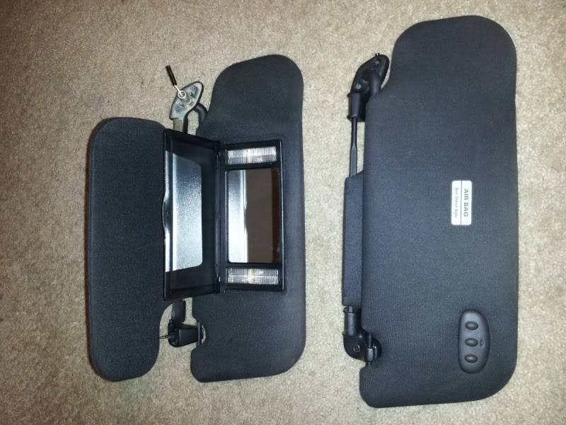

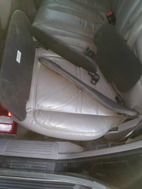

I picked up a set of 95 black sun visors with home link, with the dual visor flip down. I'm pretty sure the black is much darker than my 98s. I may be pulling the headliner and moonroof and back deck out tomorrow. The back seat and passenger set look great, driver seat has cracks in the leather but the side bolster trim panel is intact

The ones I picked up today have a single wire. The home link panel does not have the House icon. Just an LED and 3 buttons, plus the vanity lights in the mirrors
