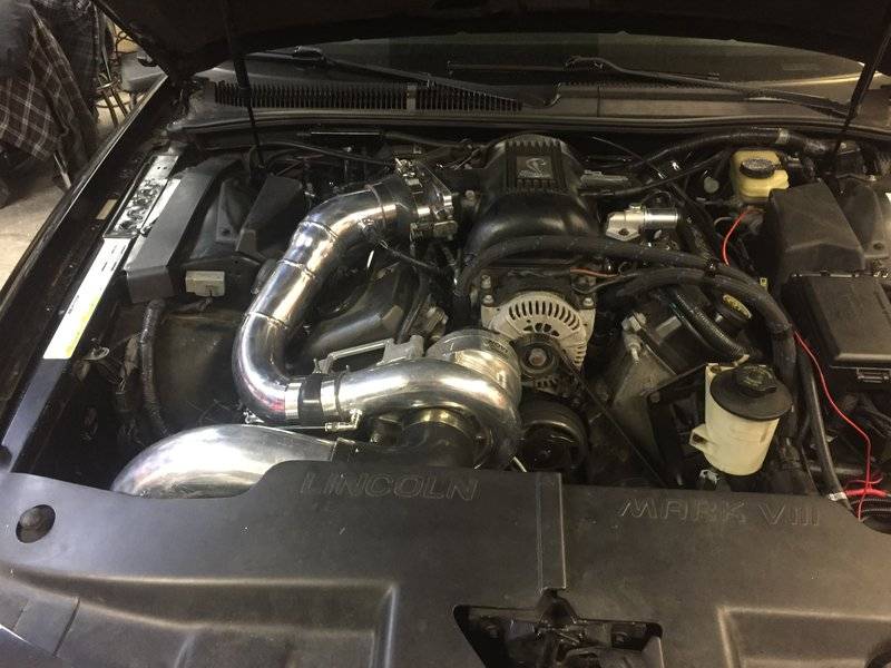

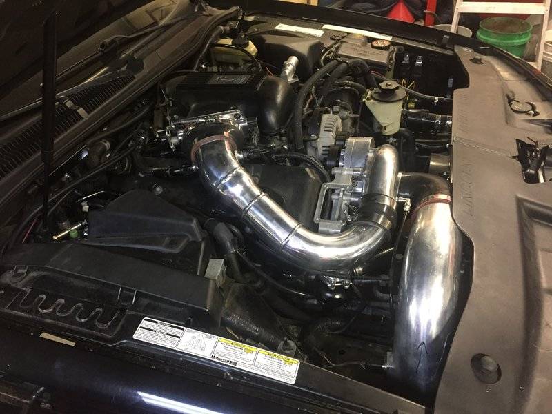

It has been a while.... Did 4:10s . Supercharger is in and finally tuned to near perfection as of this past week. I ran 13.1 with a 2.1 60'. This winter it gets exhaust and a stall. Stall is tbd at at the moment.
Du
I blew the motor up last Sunday. Not to pieces but I went in a run to tweak the tune after doing the 4k stall and it detonated one too many times. Ooops
