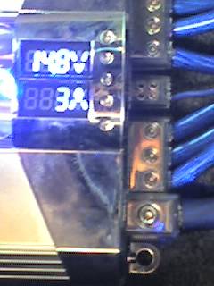

Like i said before, I have have my Ohio gen for about a year now.. Still to this day no problems.. As far as the p/n goes, I don't know about that.. But yea they are most def reliable.. Check out the pic.. This is off of my cap reading 14.8 V at a stand still with only 3 amps pulling off of the system. You could have just gotten a bad one??
