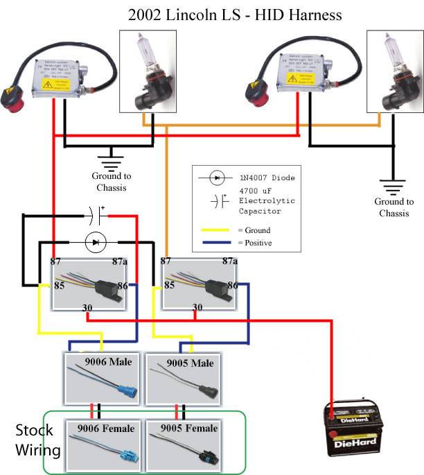

recently i just smoked my headlights on my 01 lincoln ls
lows beams are kinda hard to see, high beams arnt any better
how can irun both of them?
well i would run a relay to deliver power to the low beams triggered off of the high beams

cant just split the low beams?
yea i'm sure there is no reason that doubling the amperage traveling through the wire would be a bad ideal :rolleyes:
Jumper harness. Here you go:
Actually, this is for HID's. But you could just modify the diagram to use stock highs/lows.
