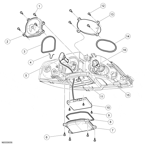

On a side note... I notice torx screws around the outside of the unit, what does taking those out get you? If I hadn't seen everyone say they have to be cut apart, I would have assumed the screws are what held the cover on.

The screws on the bottom? That's for the cover to the ballast.
No, the screws around the outside of the unit.

Some of the screws hold covers in place that allow you to change the bulbs and ballast. The screws on the top hold the front cover in place as well as the sealant. The front cover will need unscrewed then cut off.

These? Access to the bulbs and the ballast.
Thanks, I must have missed the part in Alax's video where he took the screws out.
The pictures show I cut around these so when you put it all back together, they hold the two halfs enough while the sealant cures.
