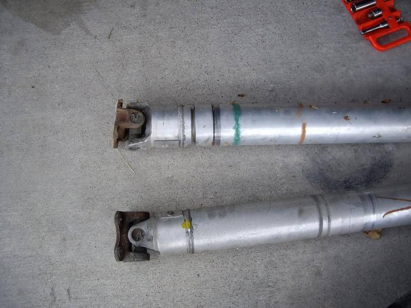

    Don't fear the gear. But I recommend you start looking for a 1993 one piece drive shaft for the vibs. I would recommend getting a tuner with the normal changes done. Look up Lance for tuner. Also the( solid axle) trac loc's don't have provisions for the IRS C clips on end of your axles. You need to machine or grind in the step for the c clips.

    Thank you. I'm getting a trac loc from Ford that's supposed to work with IRSso hopefully that'll be fine.
    It's pretty hard to find the one piece driveshaft, but I am looking for sure.

    I was able to order a 1993 one piece Mark VIII driveshaft today.

    Tons and tons of guys don't bother with rear lube mod. Just make sure you 100% get a one piece DS.

    I had the seller check it as it's out of state. He came back today and emailed me that it is indeed a one piece. I guess I won't truly know until I receive it.

    you guys seem 110% on the one piece DS. I 've had my 98 for 4.5 years now and haven't noticed any vibration. I have 138k on her now.

    Alot of peeps don't know what to look for on them. If seller is like Bruce they know mk8 stuff

      Well I bought it from a junkyard so I have no idea until it arrives.

      Hi, I have a 1994. Does mine have the one piece driveshaft?

      1993 ONLY year for one piece drive shaft.
