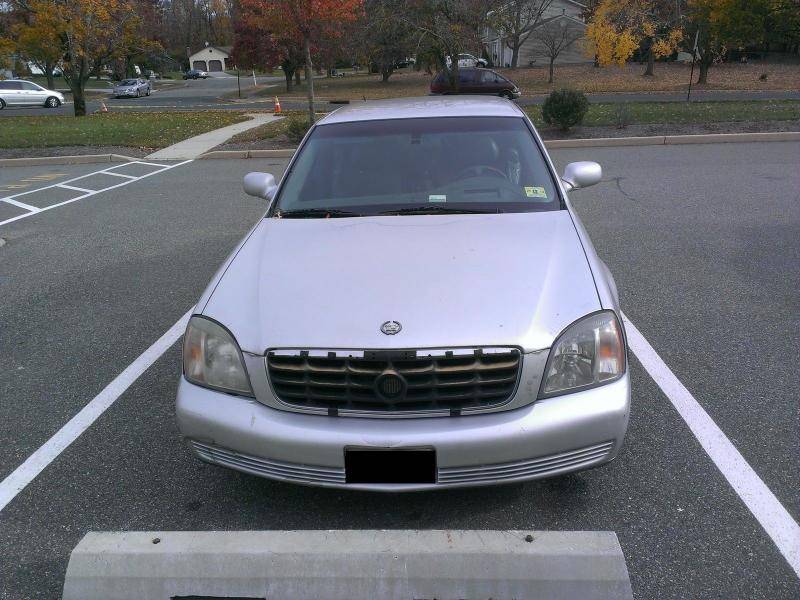

If im looking at stuff for my self, ill look at cleaner things, but something like this that might not be the best condition outside, but is mechanically sound with decent mileage. pick it up for round $1,000, put $300-$500 on cleaning up the outside, and sell it for $2,200. with this ide refinish or replace the grille, polish out the headlights clean up and tighten up the bumper, and do a buff and wax on the paint. Not looking to get rich, but when I see something like this, a DHS (the rarest of Devilles of this gen) with the night vision which also makes this even rarer, it really captures my attention LOL. Like I said though too bad about the mileage, that really rules out any profit ide make, and a car like that would do better as a parts car. Not very clean history report, 5 owners 2 accidents.
yea the lincoln is in stellar condition for the money. both inside and outside are maybe an 8/10. and the only issue is the hesitating/stumbling problem which i believe to be a coil so i will be out another $100 or so for the coil. i do details on the side so i will completely do a buff/wax/polish along with a paint correction on the car once i get her running right for now. the interior got shampooed and leather all cleaned up for free so hey im not complaining! lol
