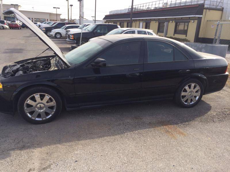

Well hello all, I'm a fresh new owner of a 2005 lincoln ls. It's got the 3.9 v8 and I got it for a steal of $800. It has 137k miles. They said it has a blown head gasket but from a quick view I think it might actually a coil pack. My friend used to own one of these they eat those things like crazy. Anyway I'll be a regular from here on. It's my second car to soon be my DD. The mustang is my current DD that I'm wanting to retire for racecar purposes.

Well the only issue it's having is it has #6 cylinder misfire. And pretty much no get up. But my friend had one. So I will be replacing all the coils and gutting the catalytic converters and if she runs great awesome! If not I'll actually replace the blown head gasket! Again even if it is the head gasket I still got a steal. I work on cars on my own so I will save myself a ton of money!! She's almost perfect a small hole in the driver seat and the rear bumper is cracked. That's it!

Jjcool those were my exact intentions. I checked and it all looks clear. The coolant is clear the oil is regular colored. I do think it need the reservoir. But like you I highly doubt it's the head gasket. I am going to replace all the coils at once and not screw around with them. I jumped on this deal as soon as I saw it. I've done just about anything when it comes to cars so I'm not a noob. Just want to put the mustang down for a bit and do a fuel engine rebuild and a 5.0 stroker kit on it so I need another DD. And well it was to good to pass up.
Joegr you're the man!! One quick question though. So if the oil and the coolant look good. The head gasket would be blown between the pistons right? So that means I would have to check the compressions of cylinders 5,6,7? Right?
Mostly true, but you would only need to look at 5 and 7 if 6 actually has a bad reading. Of course, really you usually want to do a compression test on all cylinders to verify that they all have similar compression.
