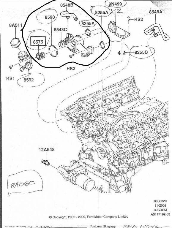

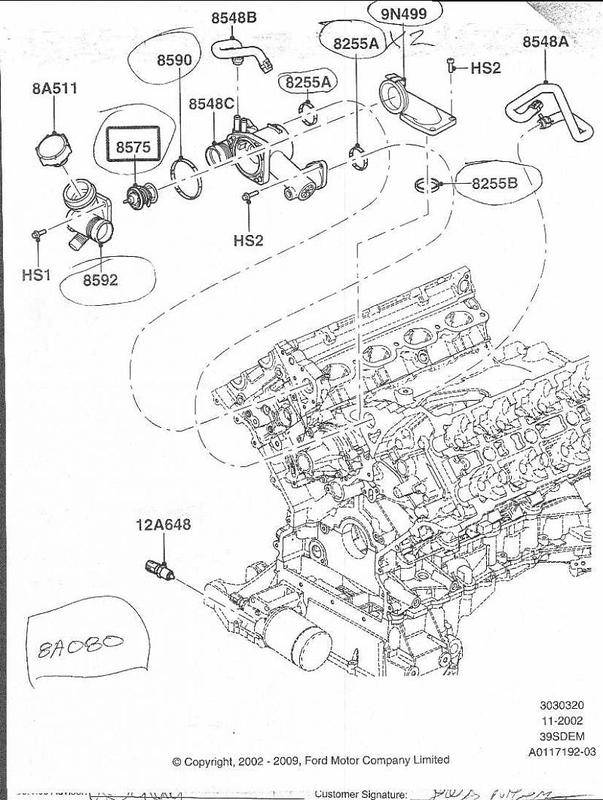

i need 8548c which i believe is the thermostat housing on the 03 ls v8
also pictured here and shipped to 07306, also what other parts would i need like gasket sets, hoses and bolts like, 8548b, hs2, and 8255a, 8575, and 8590.

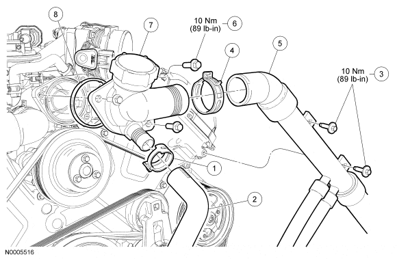

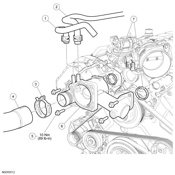

Removal and Installation
Drain the cooling system. For additional information, refer to Cooling System Draining, Filling and Bleeding in this section.
Remove the thermostat housing. For additional information, refer to Thermostat Housing in this section.
Disconnect the throttle body heater hose from the coolant outlet pipe and position aside.
Disconnect the degas bottle hose from the coolant outlet pipe and position aside.
Disconnect the upper radiator hose from the coolant outlet pipe and position aside.
Remove the 4 bolts and the coolant outlet pipe.
Inspect the 2 coolant outlet pipe seals and install new seals if necessary.
To install, tighten to 10 Nm (89 lb-in).
To install, reverse the removal procedure.
Fill and bleed the cooling system. For additional information, refer to Cooling System Draining, Filling and Bleeding in this section.
I believe the outlet pipe came with the 2 seals it needs, so I just had it, the t-stat and the t-stat housing seal (#8 replaced
