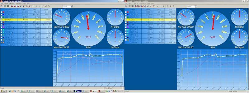

As this is a public forum, I suggest you let everyone know what they are looking at. Looks like you are datalogging your load %. The screen is really small though...
the person this was addressed to knows what he's looking at.
The screen is small because I had two datalogs open side by side on my dual monitors.
We were discussing 1-2 shift points, and accleration rate both before and after the shift....
the 6000 shift point is slower both before and after the shift than the 6300RPM 1-2 shift.
Also we were looking at the knock sensors pulling timing, quickly realized it was doing "what it was supposed to do" based on how I have my tune set up.
The car did pull .75 degree's of timing, but that was WHILE it was in the middle of adding a 2 full degree's..
It was just optimizing the spark as the tune is instructed to do via the Knock sensors.
I can post full sized images..
hell I can post the datalog files themselves and you can look at them in livelink.
