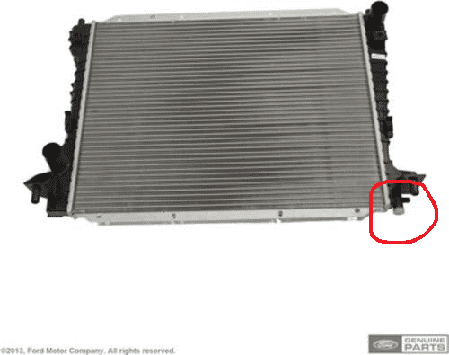

2001 lincoln ls v8 have to replace water pump looking for location of radiator drain. Thanks
It's at the bottom of the right side (right if you were sitting in the driver's seat), white knob.
Do note that there is a very specific fill and bleed procedure that you must follow to the letter. Also note that there are several plastic parts that will need to be replaced.
