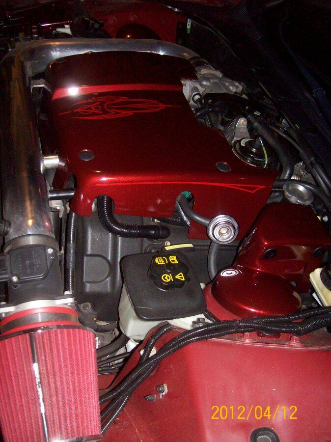

O.O Damn! Looking good!
Well, that picture is not of my engine, but another gen 1.
