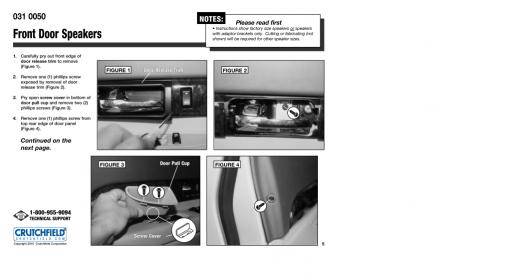

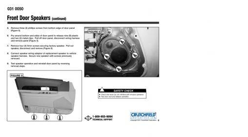

Here is a diagram that I got from crutchfield for the door panel removal with the Alpine system.
If you need the whole guide PM me and I can send it to you.

So the silver trim around the dooor handle needs to be removed and the top of the panel is held on by the white plastic fastners. Thank You All for your help.

Before I do so though, can I get a quick verification on the door panel removal? After reading the comments as well as the procedure linked by Joe, I've concluded that all I have on my 2nd gen door panel is two screws located behind the door trim panel handle (the #2 piece in linked procedure diagram). And I have no screws located behind the door trim panel applique (the #11 piece in linked procedure diagram) correct?
So other than the two screws, I just pop out the window control module and disconnect the harness? Just want to be certain so I don't break any clips etc. Thanks
... So other than the two screws, I just pop out the window control module and disconnect the harness? Just want to be certain so I don't break any clips etc. Thanks
You're missing quite a few of them.
There's one on the side, marked 5 on the diagram.
There are three at the bottom, marked 4 on the diagram.
You also have to disconnect the door handle.
Damn I hope I don't rape this door panel. I have to disconnect the door handle before I pull the panel loose? If so, how? Or do I remove all the screws, pull the panel loose and free from the clips, then disconnect the handle from the metal hangar?
...Or do I remove all the screws, pull the panel loose and free from the clips, then disconnect the handle from the metal hangar?
This, almost. You disconnect a mechanical cable from the door handle.
