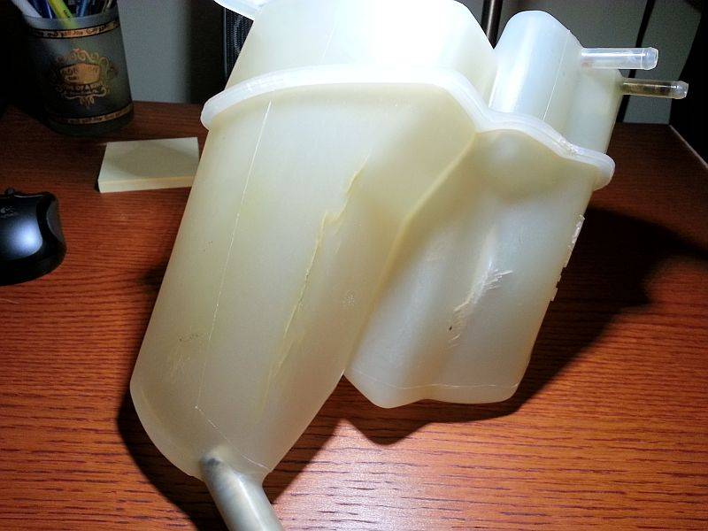

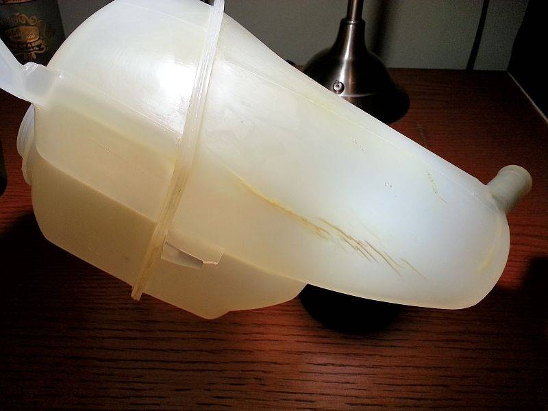

Well, whatever they want to call it Joe, I have the old one out and it matches up with the
new expensive Canadian #8A080 Tank Assy - Radiator Overflow. Pheww!
gonna have to work on the rest tomorrow, watching Hockey at the moment,
I lost focus on the whole degas thing, soon as the old lady yelled; "Games'on" into the garage.
Damn Degas ...
This thing had more holes in it then a block of Swiss cheese!
The wife, she's such a sweetheart, "can't you just glue it?"
~ No, honey, that's only your car that gets the glue and duct tape!
