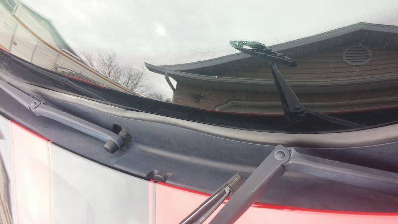

Is this the seal you are talking about right? look at it it's all messed up and kind of tucked under the window in a spot

...Is this the seal you are talking about right? look at it it's all messed up and kind of tucked under the window in a spot
Actually, no it's not. (Though that one probably needs to be replaced too. The seals are under the cowl, around the wiper shafts. Usually, it is just the passenger side one that is the problem.

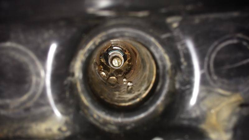

The bolts are really difficult to get to. I think I left the bottom rear one off as well.
Is it just me, or does the hex on that plug look fubar?
On the bright side, at least there's no oil in there!

...Is it just me, or does the hex on that plug look fubar?
That's not a plug, and it would be really odd for oil to get there.
oh, looked to me like he was trying to show water in the plug well. what is it? wiper shaft?
I thought so, but I think you are right. I think the angle blocks any view of the very base of the plug.
(Looking at a 3D object in 2D, it looked like it was protruding the first time, not it does not.)
