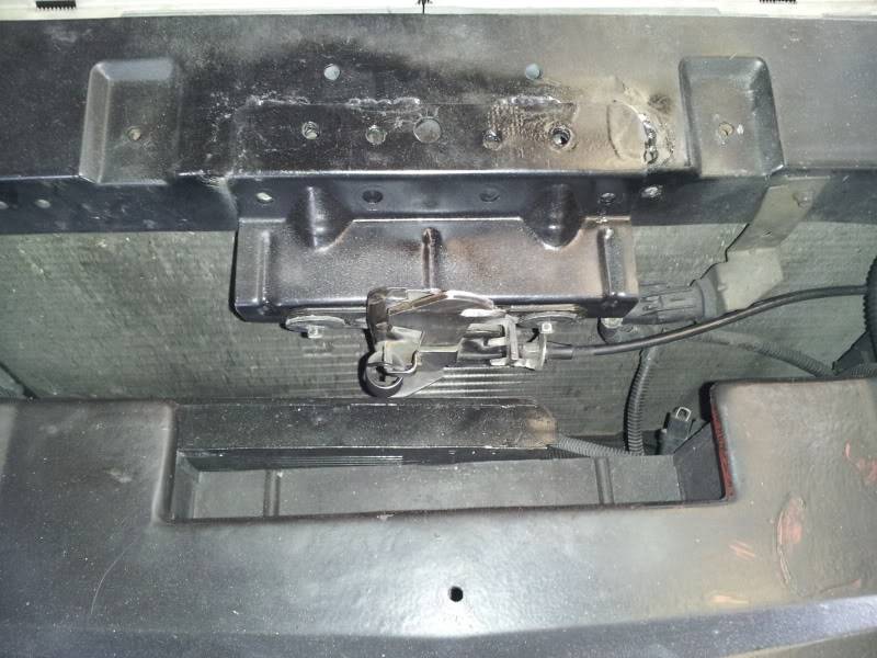

This angle probably doesn't help much , but its all I got
And yes the cable bracket has been modified
the striker (latch) is not adjustable...but it is cleanable..
I had issues with mine not closing easily, then popping up around 70mph...I had it at the local Ford stealership to get the bumper painted; they took the latch apart, cleaned it, spooged it with some greasey love, then put it back together
...now that :q closes and locks upon it's own weight dropping and never pops up at high mph
Lubing it is a good idea, but it is adjustable by about an inch side to side and up and down. The latches bolts in the front are inside large squares that give you moving room

Adjust your latch, same happened with mine, and I moved it . Just look where the striker is hitting, when you close the hood, so you can know where to move it to.
When I got mine the hood was hard to close and the last guy had cracked the front lip on the hood from slamming it. There's another thing; don't shut the hood with your hands close to the front lip. I replaced the hood and now I always spread my hands out to shut it.
Anyway, it took my friend about five minutes to adjust the latch so it shut properly.
