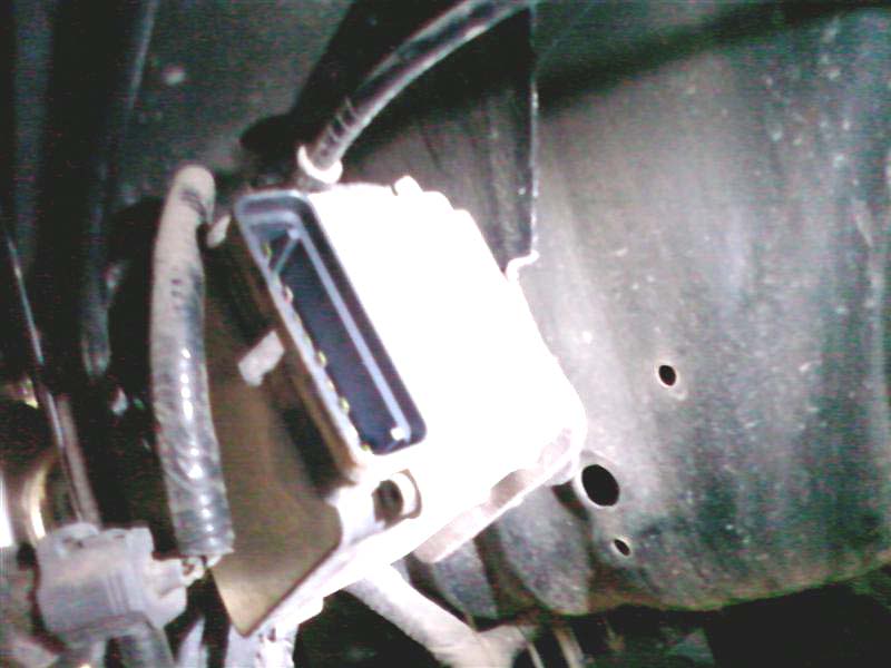

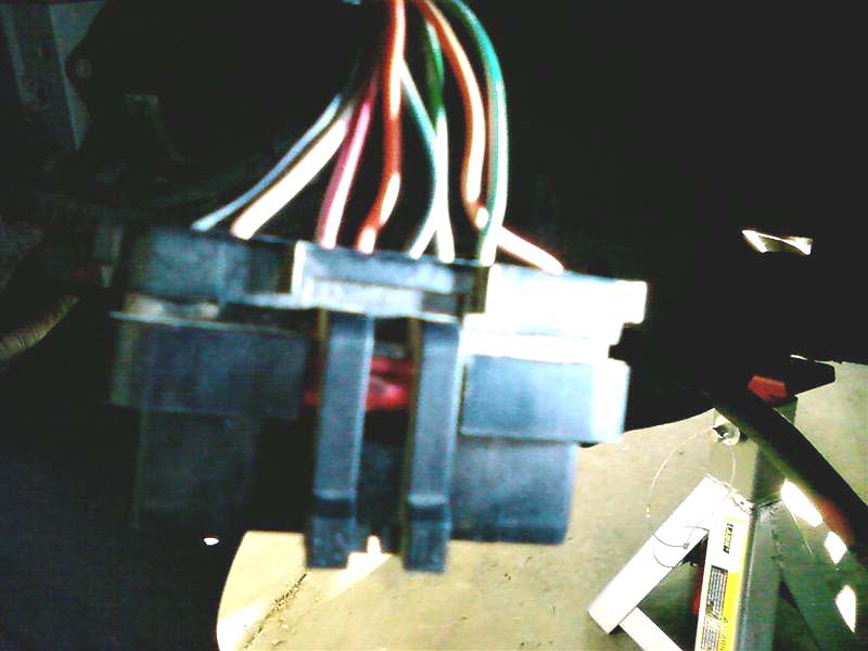

my neon ballast is dead..........unity was right problem was in the back.
unplugged it, replaced fuse 32, back to normal........except no parking lights, fuse 31 was blown too............

Hey now, only maybe part right. Have you tried putting 12 volt directly to the ballast? Spare battery sorta thing? I dont wanna keep beating a dead horse, but that trunk harness has bit a a few in the ass! Just want to make sure its indeed the ballast and not the harness. :)

i checked the harness for continuity with my meter it checked out fine, took it out, checked it again, moving the harness around and wires were good, then i taped up the piece that was uncovered and added more to the part were it bends......... everything is working fine now, except the neon, left it unplugged..........looks like crap with no neon on :(
i think the trunk wire issue that unity speaks of is more of a gen 1 problem. glad you found the prob, too bad about your ballast though :( but dont feel too bad my ballast is bad too, it just dont blow fuses
