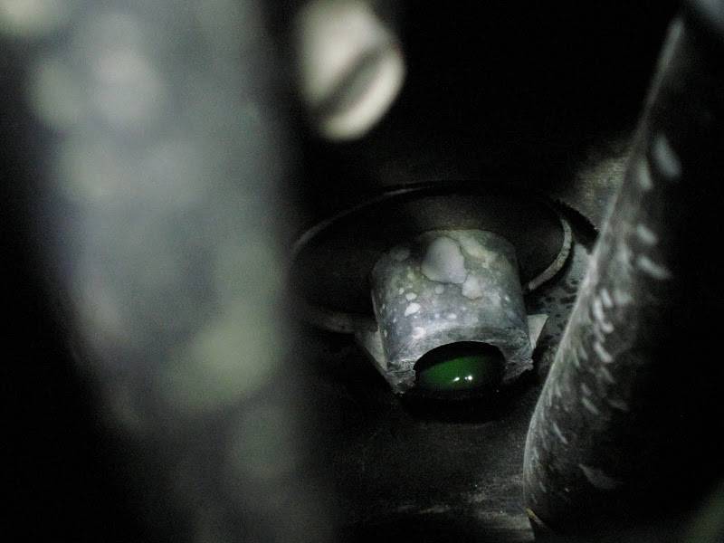

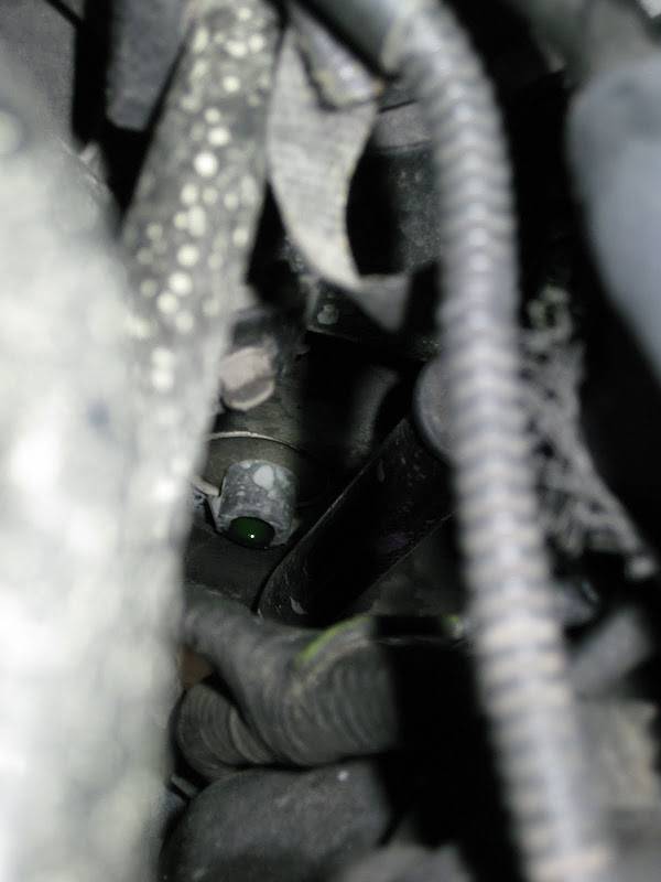

My 97 is leaking antifreeze from what looks like a weep-hole beneath the heater core and to the left a little bit as seen from the front of the vehicle, in the engine compartment on the firewall. I can't think of what else it could be. Looking at it closely, it kinda looks like there may be something that attaches to it, but I don't know what. Here's a couple pictures...

Here's a picture of a Mark VIII with the engine out. You can see the hole that I'm talking about a little better. It's just a little to the right of the bottom of the A/C canister.

That is the AC drain hole. Your heater core is indeed shot as coolant leaking from it is a sure sign.
That is the correct answer in all this. If you ever look under your car with the a/c on, that is where the water on the ground is coming from.
