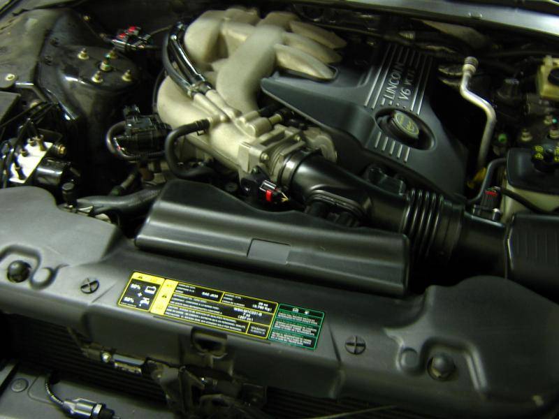

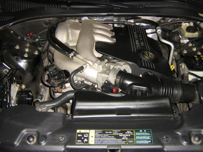

detailed the engine area took some pictures disconnected the battery a few hrs ago just connected back have not driven it yet

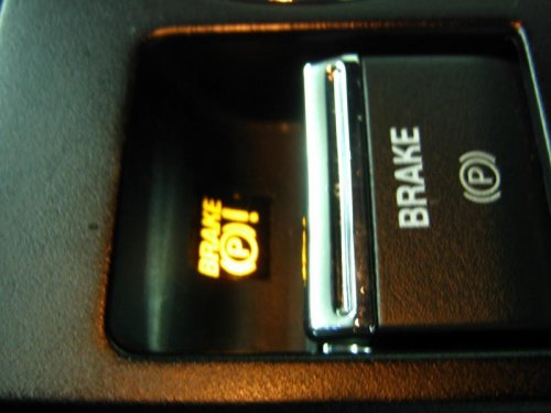

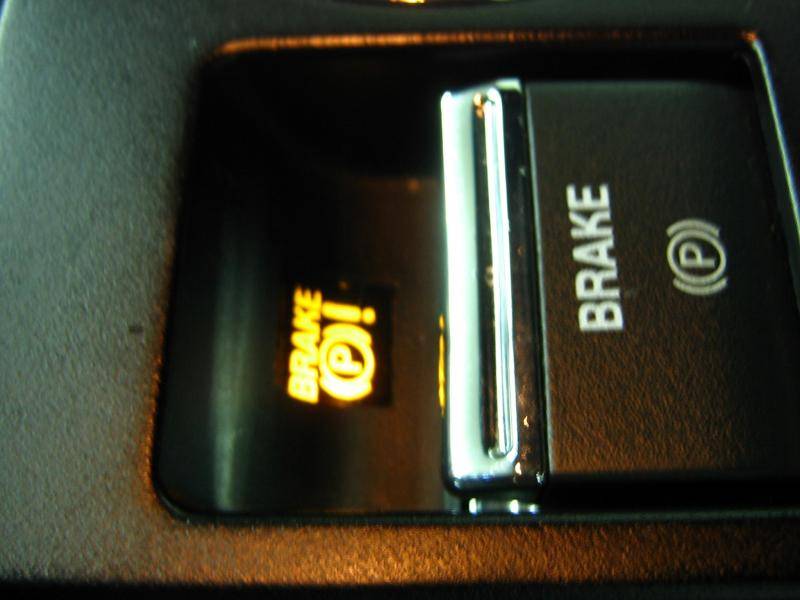

So, have you ever even tried the e-brake initialize procedure?
Basically, put the car in neutral and hold pressure on the brake pedal. Set the parking brake, wait several seconds, release the parking brake. Drive a little ways and then use the parking brake when you park. The light should be off when you restart it a while later.
