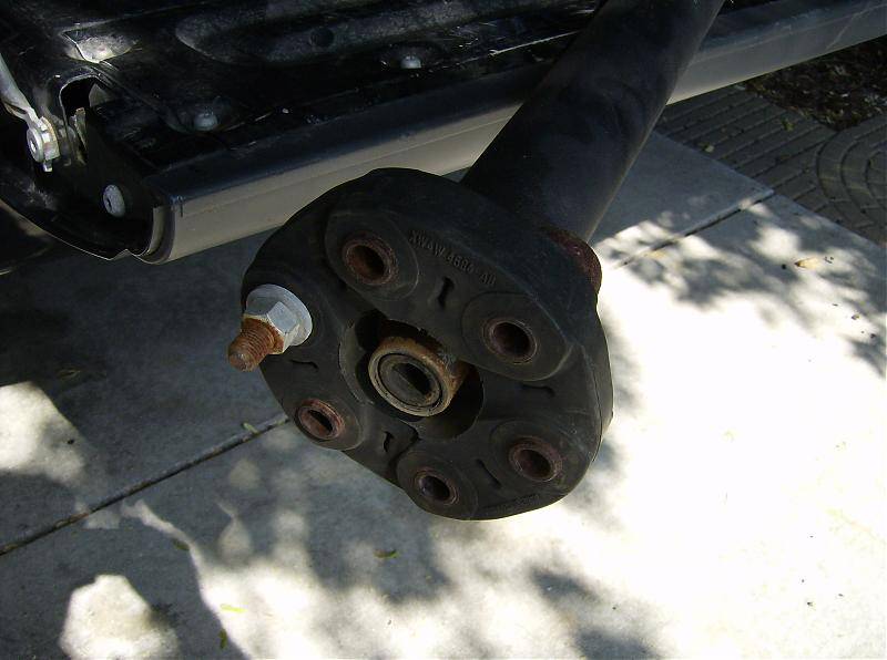

Guibo=flex coupler.
Our driveshaft has one on each end and power is driven through them.
