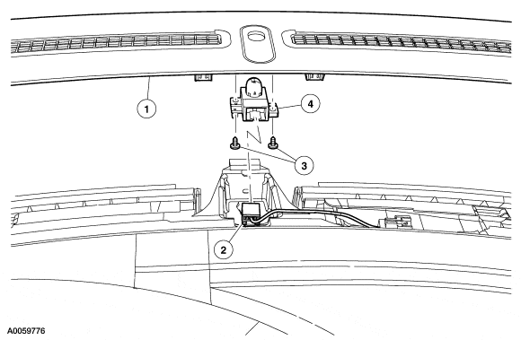

Does anyone know what causes the automatic lights to stay on all the time? In auto mode they never go off. I disconnected the mirror thinking that may do something, but they never went off.
Your auto light control sensor may have gone bad. Top center of dash near windshield. Think this is the PN xw4z-19e663-aa
dang... I was wondering if thats what it was. Do you have to pull the entire dash to get to it?

Nevermind... I found it! :D

Edit: Since this is my wife's commuter, she will not use the manual mode for the lights. If the auto lamps don't work the lights will just stay on... That's not so bad, but the instrument cluster dims and the navigation is in permanent night mode.
Those autolamp sensors aren't too bad to change. Took me about half an hour with a buddy to change one in a Yukon awhile back.

also the light sensor is super easy to change out, pull off A pillars, unsnap defroster vent panel, unscrew photo sensor, reverse to reassemble! without having a clue what your doing, this should take no more than 20 minutes.
