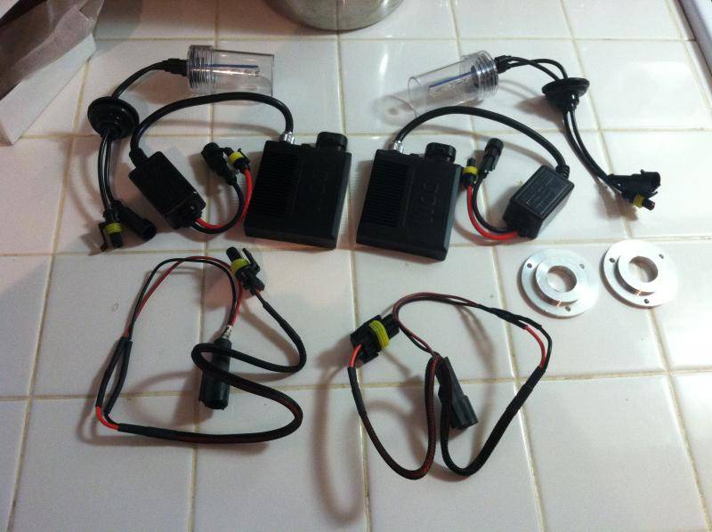

Do those require an adapter or anything on top of the $36?
They all need adapters. There are no other bulbs made that secure to the housings in the sad way that the factory 9500 bulbs do.
You'll also need to cut and splice the new ballasts into your factory wiring, since they use different harnesses.

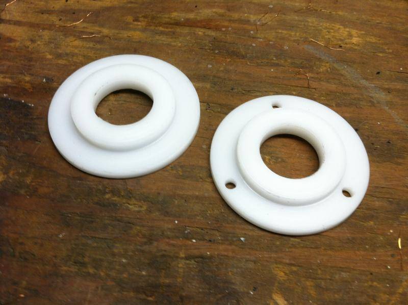

98lincmk7lsc makes the proper adapters pm him. There are no kits that plug into your factory harness meant for the original sylvania HID bulbs. I don't know exactly which wires need to be cut and spliced into the kit but if I were you I'd add a 9006 bulb connector to whatever wires you chop off so that way the hid kit can be plugged in and removed if needed, rather than hard wired in.

Here are some pictures for you.

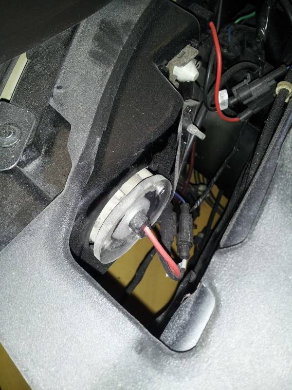

I use the Xentec with no issues, mines a Gen2 and was just plug n play. Since my nose is a Gen 1 I had to make rings for the low beams.
3/8 Plexiglas and the foam sleeve supplied with the bulbs.
Took about 20 minutes to make both with a dremel tool.
Everythings so dusty ;( whole car is being sanded at the moment lol
