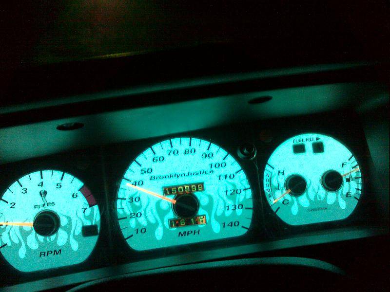

Got my SpeedHut insterment cluster installed.
ramairmustang
Oct 2, 2009
103
Seven Mile

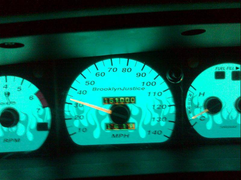

I ordered these from www.speedhut.com I love it. Looks amazing and the upgraded inverter came with two colors Blue and Green. I used 22-16ga splicers for both pos and neg to supply power. I just tapped into the power wire were the little tiny Light is in the headlight switch. Mounted the Inverter on the metal just above the fuse panel when you remove the cover. I cleanned it with rubbing alcohol first. That allows me to choose the color and brightness via the inverter. If you splice in where i did on the power place you can dim it using the dimer. The kit is very easy to install. I used some paper tape to mark my needle locations on the black cover piece to make reinstalling the needles less of a pain. Everything is spot on with my gps speed reading. Sorry pictures are from my ter however if spliced in to same Cell Phone. It's got the Silver Metalic background, cobra on tach and my nieces names on the speedometer. Brooklyn and Justice.

Had to get the flames Brooklyn and Justice both wanted me to get the flames so being that I cant tell them no and that I was getting it just for them I had to. Otherwise I would have passed on that. They also wanted me to color there names that I have tattoo'd on my arm Pink for Justice and Blue for Brooklyn but I was able to talk Justice into Blue like her big sis. LOL. If you cant tell my nieces are my world.
