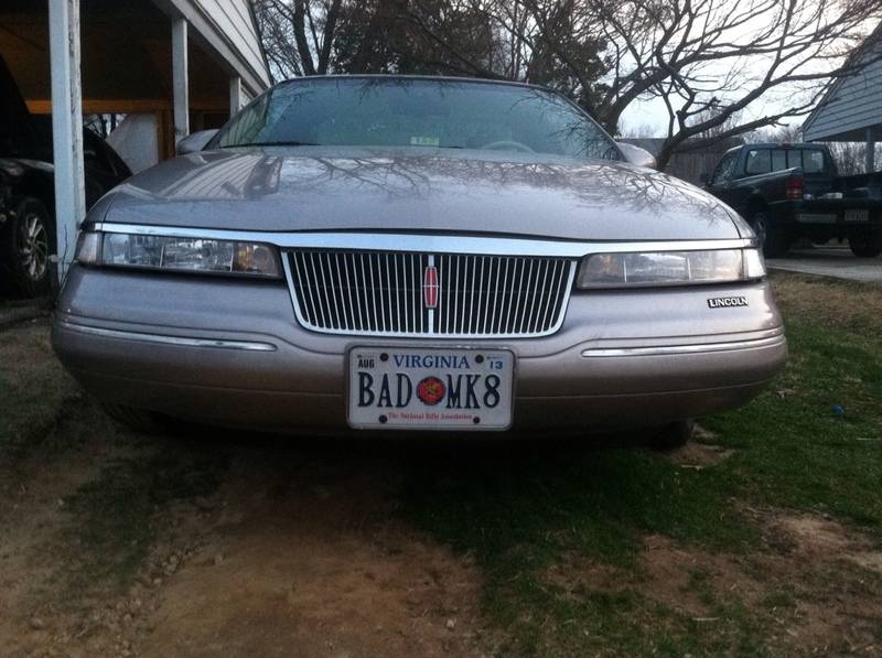

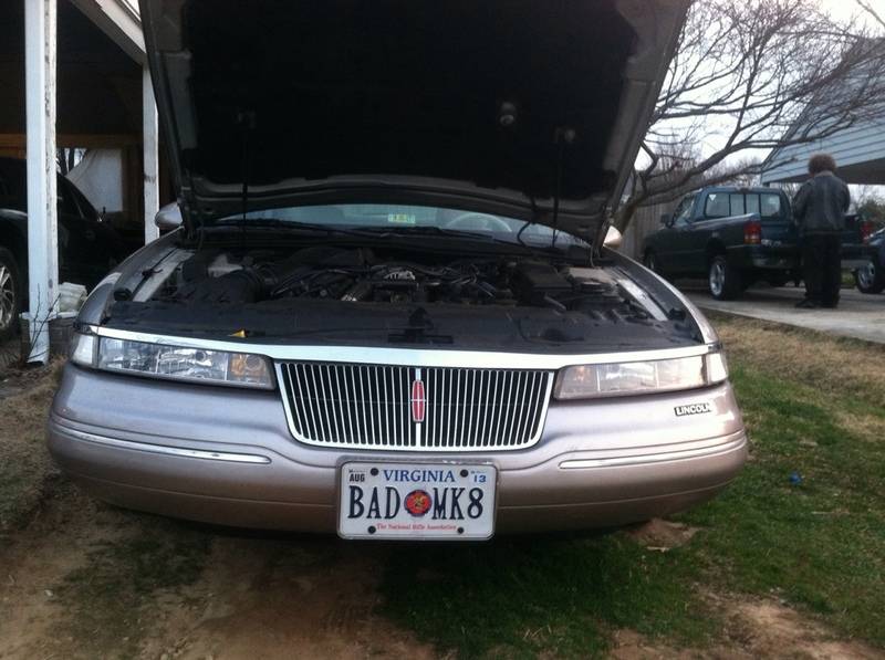

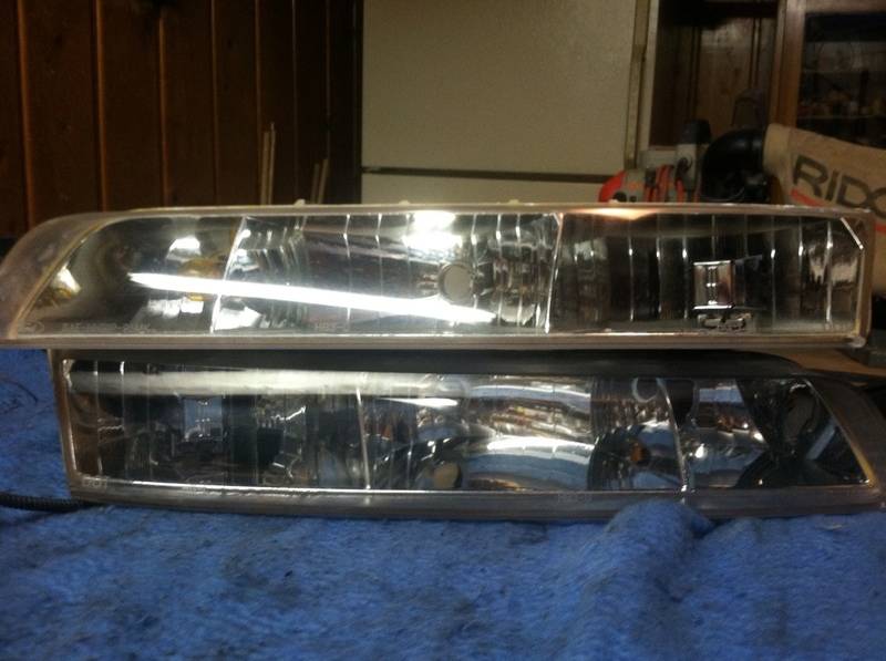

Cleaned up my LSC headlights!!!! :cool:
And put them in my Mark!!!! installed the header panel from the 96 LSC into my 95, also put in the grill from the 96

I started with 1000 grit and wet sanded the headlights. Then I used 1200, 1500 then 2000 grit to finish it.
After the sanding was compleat I used 3M's heavy duty buffing compound on my buffer and buffed it. After that I used 3M's machine polish, then 2 coats of wax. Be Sure you wax the head lights every time you wax the car.
