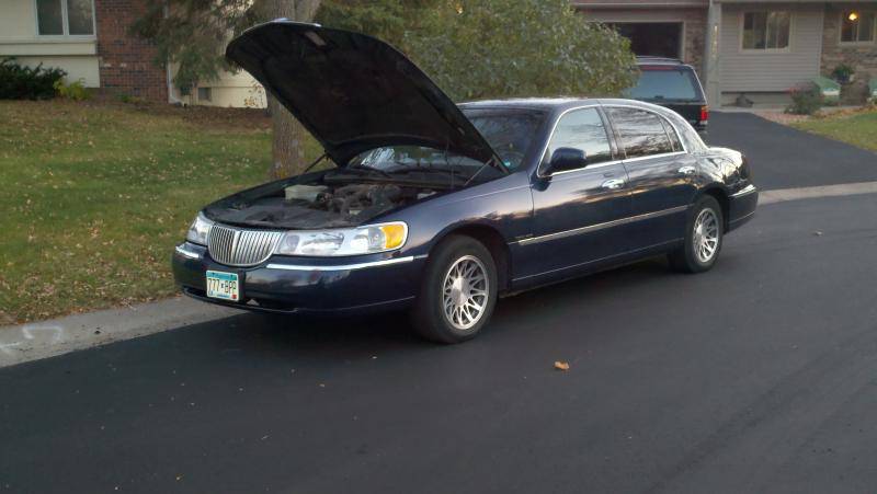

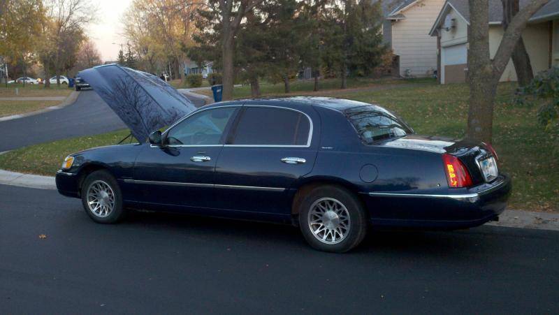

2001 Town Car signature series. Dark blue with a grey interior.
Other than a few small issues I love it! So much nicer then my previous winter cars. Ride's allot better then the mark too. I will be putting the mark away for winter here this weekend and this will be the daily for a while.
It has a few issues but for a 9 year old car with 160k on it I cant complain, it needs
-Front Wheel Bearings
-Upper and Lower Ball Joints
-EGR
-Coolant Flush
-Front Pads and Rotors
-A buff job
I also need to figure out why the heated seats don’t work too. Do any of you know if they ever came with a factory CD player? That would be nice to have.
I’ll get some better pictures up but here are 2 to start with. No rust either for a MN car.

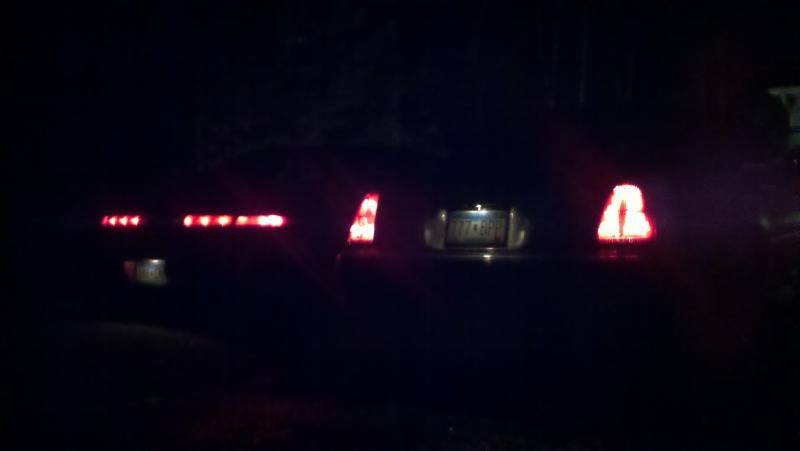

Changed the oil this weekend, fixed a few dead bulbs, tires were all at 35 psi, brought them up to 45psi, new wipers and had the check engine light scanned and found out my EGR was bad so I replaced that and the light went off, but unfortunately on my way into work this morning it came back on and now my running lights are inop. I still love the car!
id bet money you need a DPFE sensor. it looks at exhaust psi in the egr tube to determine if the valve is opening or not. follow your egr tube and you will see 2 rubber hoses running from it to a small rectangle sensor with a 3 wire plug, either that sensor is full of condensation or the rubber hoses deteriorated. it will show the egr valve not opening etc and autozone will be the first to sell you a egr valve. ford has a tsb for all cars with egr insufficient flow or any code of the sort that step 1 in diagnosing it is to replace the dpfe, ive only seen maybe 3 cars out of 1000 that the sensor didnt fix the light
Good to know, I'll have to check that out latter. You wouldnt happen to have a picture of the running lights fuse location would ya?

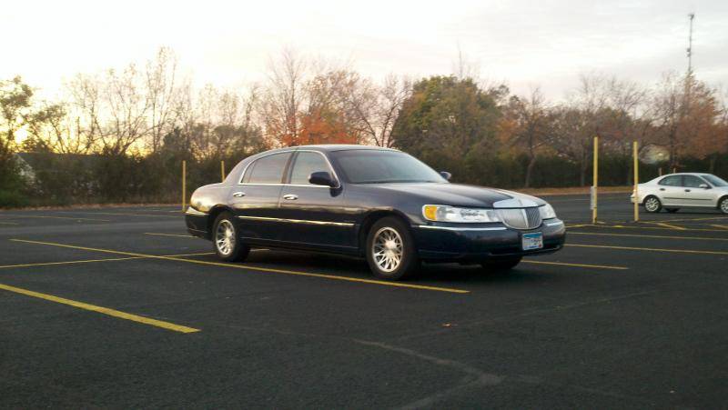

It's actully dark blue, more classy then black! Tire says 45....I give it 45
