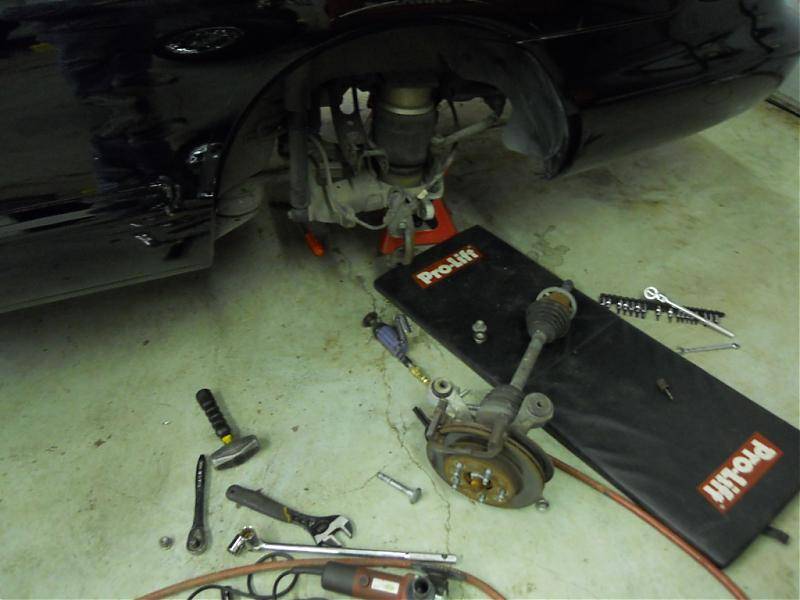

I don't want the pumpkin. I already have a built rear. I just want the parts it takes to make a bolt on hubswap
150 for hubs is kinda high might hit up a salvage yard and mustang hubs for the front new are like 35 bucks each
The 93' I got my DS from has a broken knuckle unfortunately :(
Otherwise it woulda been a real score :D
I'm thinking I should txt him and see what the ECU in that thing is?
what i want is 2 of those axel/knuckle/brake disc assemblys on the floor in the pic, but with 5x4.5 hubs and brakes. then i can swap those in by just undoing the 3 knuckle bolts and swapping the brakes. for the rears at least
Exactly what I wanted to do.
I would jump on it, rebuild the whole thing.
Do what your thinking plus get in touch with Doug and put bushing in it.
Buy it.
Buy it.
oh yeah. and when your done rebuilding, subframe swap and your done. i like that idea.
