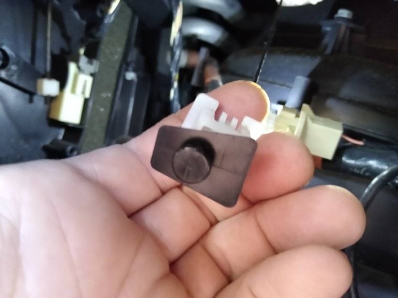

Thought I'd add some pictures to this old post. This is the end of the string that limits the opening of the compartment.

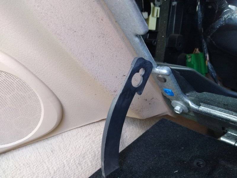

Below is the keyway it fits into. Pull forward then remove sideways.
