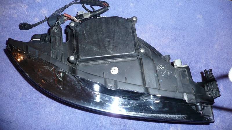

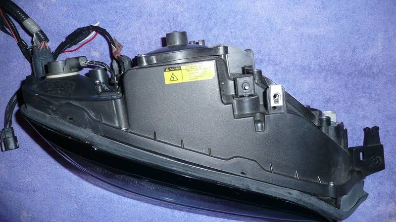

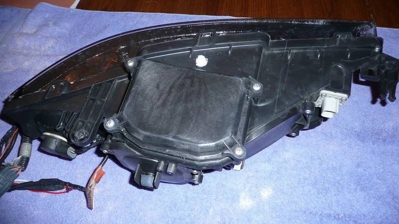

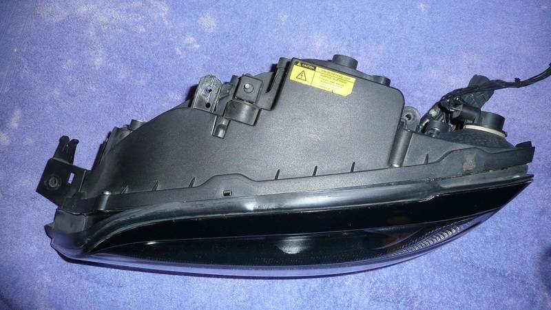

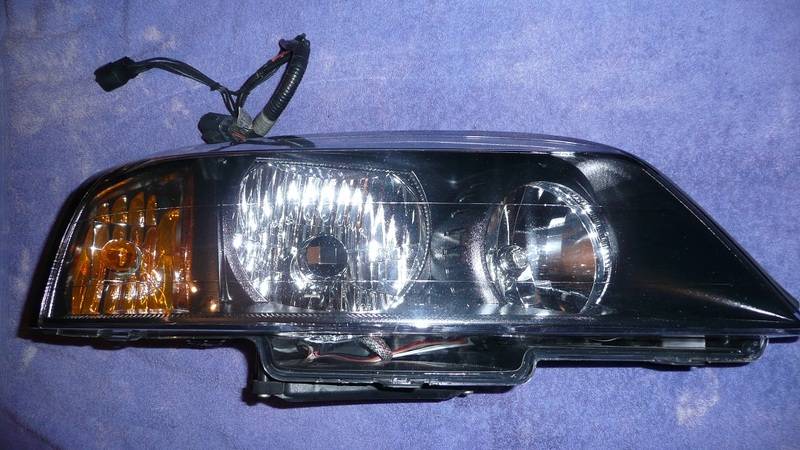

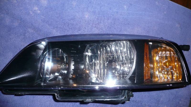

And lucky for you - I'm pretty sure they include all the harnesses you need to plug right into a 1st Gen LS! I had to make these up when I put 2nd Gen headlights on my '02....
OEM HID Xenon Headlights – These were ridiculously priced at one point if you could even find a set, I will start them at $600 – this is pretty close to what I see them on eBay for in worse condition.
$600 for a pair? dang, you used to have to wear a mask to get a deal that good! lol
