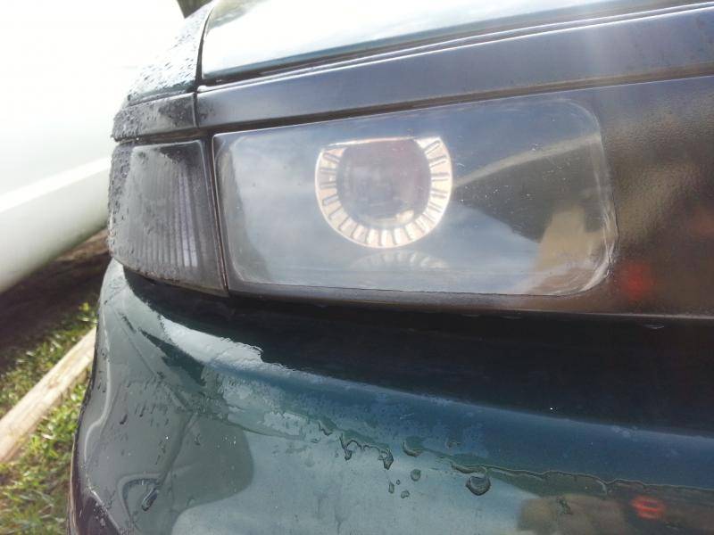

Of all the DIY mods out there on these housings, this is by far the best looking.

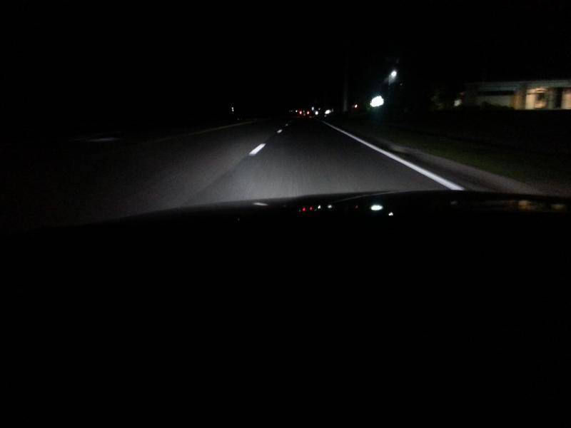

Horrible picture taken from my phone but I think you get the idea...
The streets really are lit up now and I can actually see pedestrians now

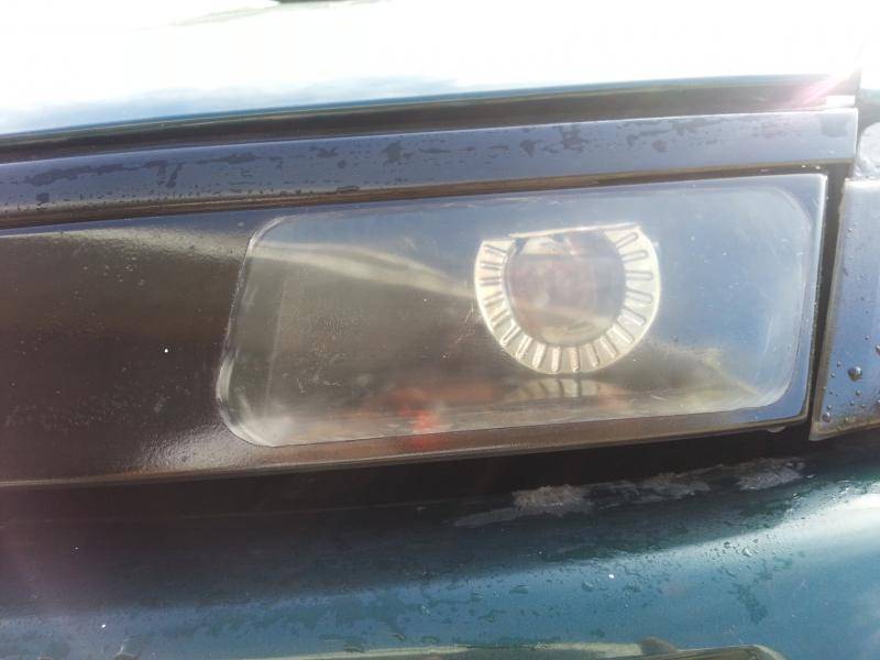

Nice work! Can you show more how you mounted the projector in the housing?
I had to open the original bulb opening a little on the top because it didn't line up with the projector (as seen on post 14) the it just bolted together through the opening. attached is a link to the site for the projectors I used. I installed them in this order:
Projector;Large silicon washer;headlight housing;H7 metal washer;locking nut: picture/direction #4 in the link gives a good picture of how it goes together.

I would buy a set of these in a heartbeat. Really nice work PIP.
Thanks! It would be much easier to buy a set that's for sure! I keep debating on opening up my original headlights and re working the lens as time allows or just leaving them alone so I can swap them out if and when I sell the mark so I could sell the lights. I am kind of torn right now but with other projects invading I won't open them up until I have the time.

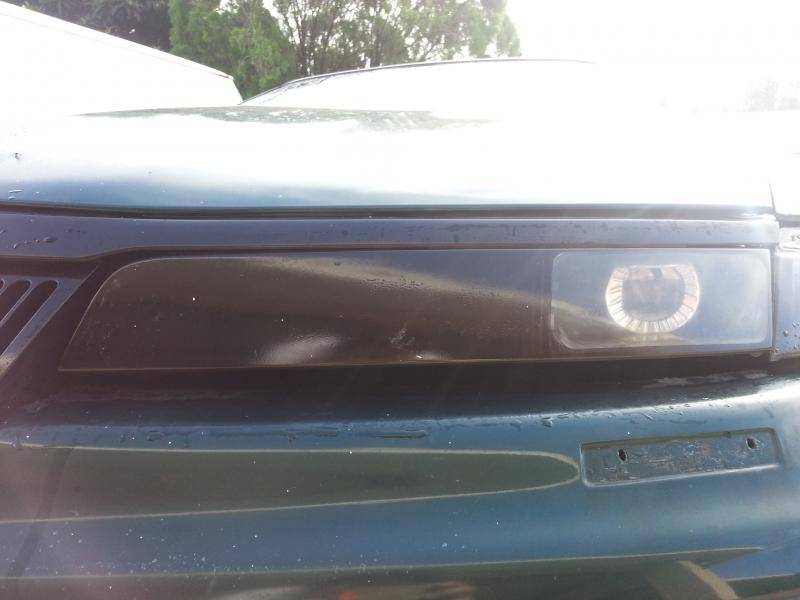

Can you take a pic with the forward facing turn signal/running lights working?
I have a couple on the first page, was there a different shot you wanted?

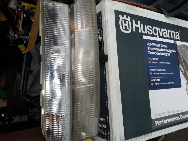

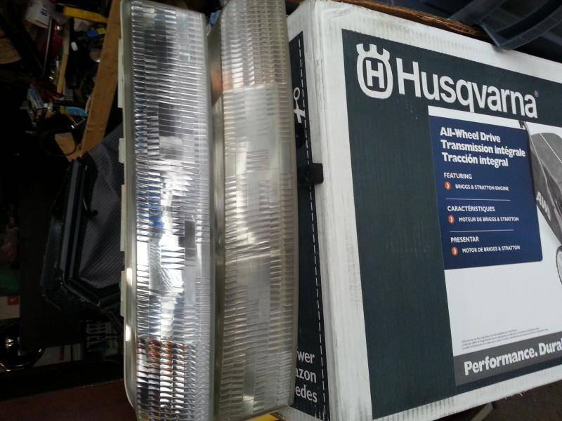

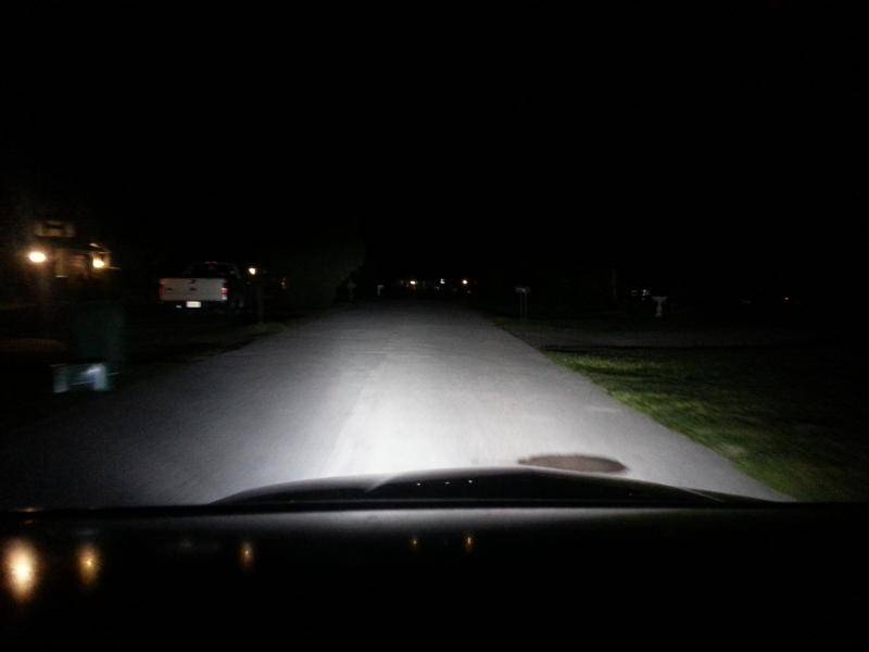

So its been a year now and the lens have turned yellow on me and I believe it is from the inside this time. So I am going to take on the task of making new lens for these but not sure when. In the mean time to hold me over, the other day while walking through the LKQ in Daytona I came across I 93 with 40k miles on it with the headlights still attached. Talk about weird- I dont think I have ever seen a M8 with the headlights still on it. So I pulled one off and inspected it and nothing was burnt and all the chrome was still in good shape. It was had to see just hiw good because the lens were yellowed but I took A chance and bought them both. I sanded them and polished them and what a find! These things are beautiful! I put a regular halogen bulb in it and compared it to an old assembly I had and the lights output was fantastic. So to hold me over I purchased a set of 9006 bulbs to put in the housing since it has the reflectors in front of the bulb so I dont have to worry about blinding on coming cars. If the rain holds up tonight I want to put them in and see how they do. 20150826_184016.jpg
Wish me luck!

Well let me tell you what- the factory housing with some 6000k hid bulbs put out much light then my projectors ever did. I am amazed with how much light I have now. Cant wait to really drive it and check them out at night. Makes me question if I want to make new lens for the projector setup I just pulled off.
