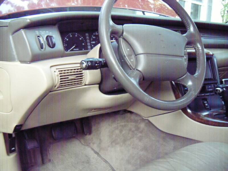

Knee panel under the steering wheel? I forget how big it is.
Got a pic?

The panel below the steering wheel on the top portion on either side?
I like the ashtray idea better but that's more work and you'd be comprimising the whole assembly. Again, I haven't seen pics of the asham in some time so I forget what kinda size were talkin' bout here.

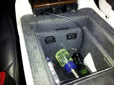

The last time I saw it, I thought it was mounted inside the console. That's where I have my two Rays Switches mounted. Mine are mounted on the front wall of the inner console and can't be seen unless the lid is opened.I know what you have is made differently.
Gotcha, didn't know if you had done it... I'll look at that, seems easier than an ashtray install. I'll see how tough the ashtray is first.
That's Sexy...
For whatever reason I thought you said you didn't want it in the center console. :slam
That is by far the best place.

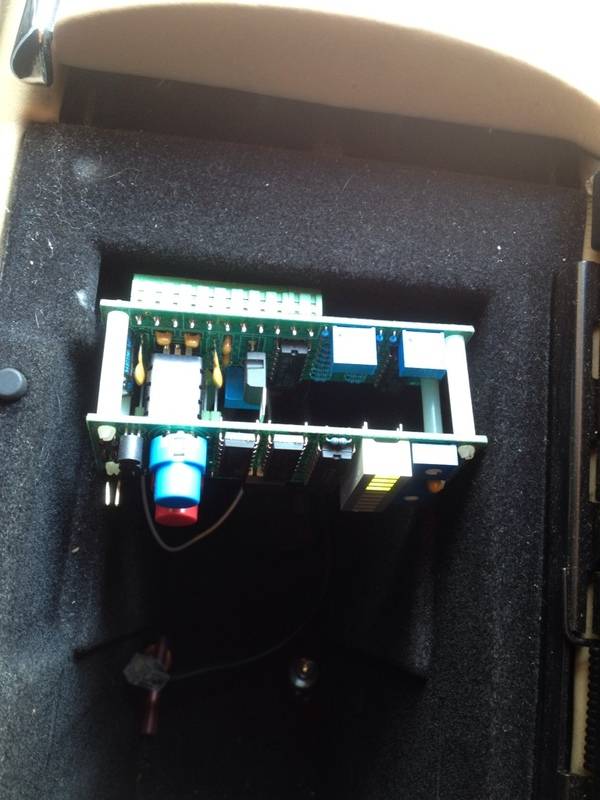

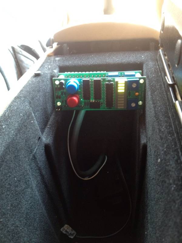

Mines mounted in the center console I'll get some pics when I get home I dont have a cover for it yet but it works well in there
Here it is mind you it's not finished but once the face plate is built it will be solid in there.
Thanks for all the ideas and pics, I've got a couple extra center consoles to play with so I'm seeing what can be done under the cigarette/lighter door and in the center console to make it look some what factory. Pics to follow
