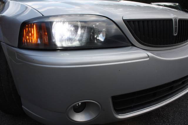

When I did my conversion I bought the pieces individually from team ford because it was cheaper than the package. So, you might want to try that, and check out tasca parts for better prices. Now the gap isn't really bad, but it still bugs me. The body shop offered to "glass" in the gap, but I didn't have the cash for it. I also planned, & still plan, on swapping to the gen 2 headlights, eventually. Here are some pics.....and yes my driver's side is worse than the pass side. It was tweaked when I bought it, and I got sideswiped by an Explorer before I got the LSE bumper.
Drivers Side Looking Down
Drivers Side Head on
Pass Side Looking Down
Pass Side Head On

Yes the price is for a gen 2 LSE bumper. Also, I did mean fiberglass the gap. I believe an old member named fonsito had it done. All it does is fill in the gap.
