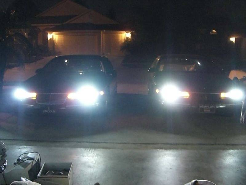

rich i have 6000k's in my black 93 also, and my green 93 has factory hid's in it and the 6000's are brighter look at this pic. factory hid's on the right, my 6000k's on the left.
They both look pretty good! Isn't it true that the higher up the kelvin color scale you go, the less usable light output? That's what all of the HID websites that I found have said. Maybe the 4300K & 6000K are pretty similar, or maybe it's because of the older stock HID's vs. the new HID's??
I think that one thing is for sure though, if you get the 8000K (blue) or the 12000K (violet) then you will lose light output.
I do agree about the picture above though. You must really like mark VIII's!
