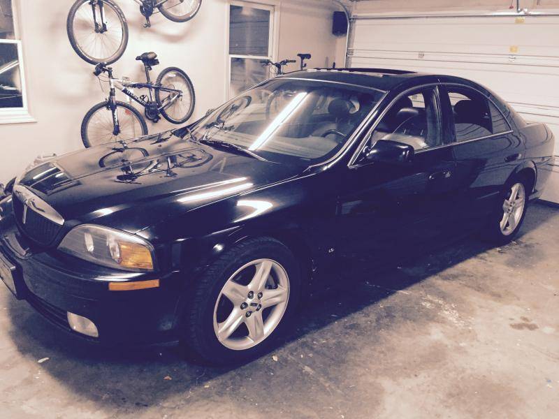

Guys,
I am trying to read up and determine whether my 2000 Lincoln LS is a "sport" or a "non-sport". Is this distinction purely a matter of how much wood grain and chrome is on the car?
I have seen mention that the "sport" may or may not have stiffer shocks, but when I was shopping for shocks for that car, the ones on Rock Auto-dot-com, Advanced Auto and other sites did not mention anything about sport vs non-sport.
The Wikipedia page on Lincoln LS has alot of information about the cars, but the site does not mention a "sport" vs a "non-sport".
I have also seen people comment on this forum about some kind of electronic speed limiter, again that may or may not be on the "sport", and there seems to be mixed information about that. Any truth?
...and yes, I just read through the "differences between sport vs non-sport" post, and its where I am getting most of my confusion from.
Anyone know how to tell on a Gen 1? Is it marked on the car anywhere?
That's a sport. Sport does have different shocks and roll bar, 17" wheels instead of 16", oil cooler on the engine, ...
You can't really tell by the interior, but no chrome on the bumpers and 17" wheels = sport.
The ETIS site does not say sport/non-sport, but if it is sport, it will show as special suspension.
Note that you can no longer get the OEM sport shocks anyway. The non-sport will fit just fine, but you may prefer your worn sport shocks to new non-sport shocks.
I think the other big thing from what I was told as far as it being an OEM sport is that they would only come as V8, or the V6 manual. In otherwords, I think a V6 auto would always be non sport. Joe (and couple others) probably can confirm this.
In the Gen 1 you could get the sport package with either engine. There were one or two one-off Gen 2 V6 sports running around...

That's a 1[SUP]st[/SUP] GEN 2000 Lincoln LS V8 Sport.
as Joe mentioned, it's termed "Special Suspension'.
