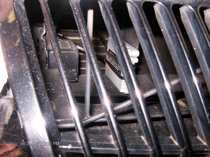

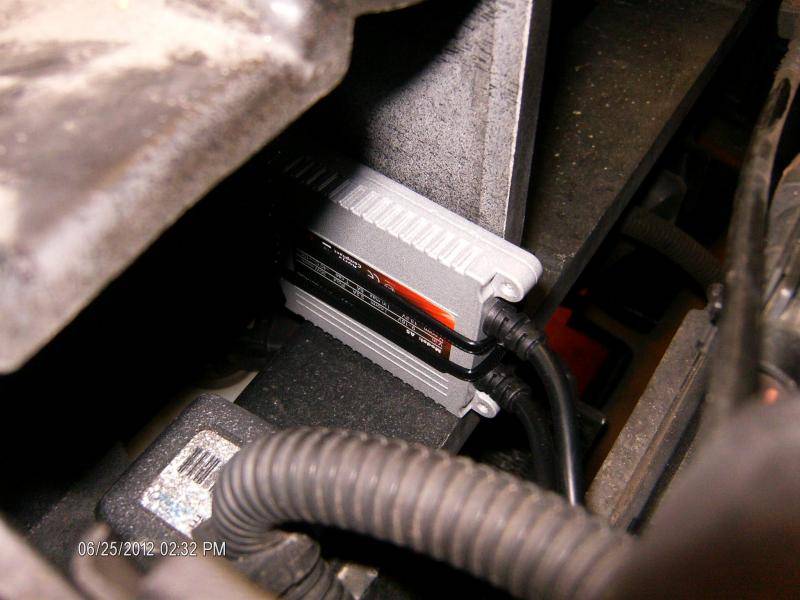

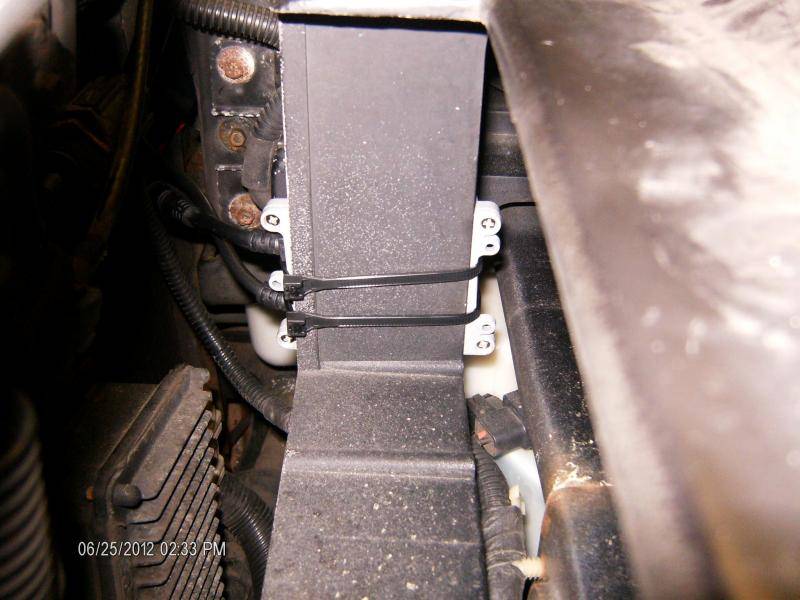

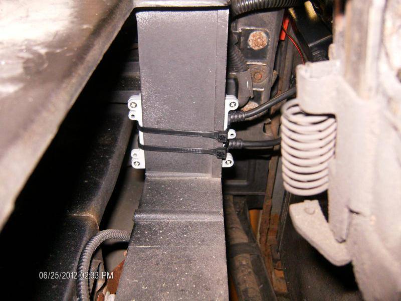

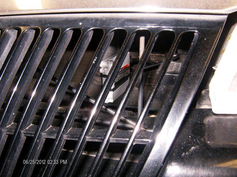

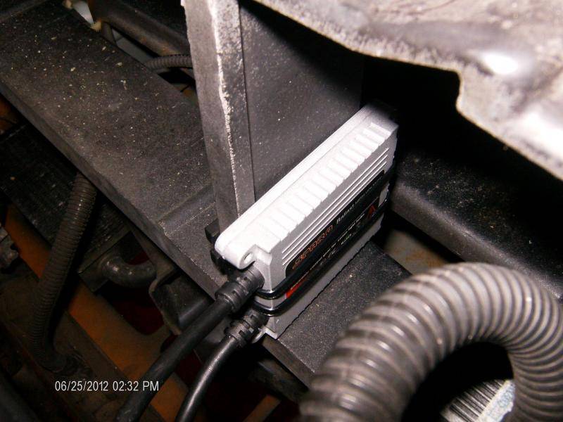

You can see where and how I mounted the ballasts to the header panel in these pics. HID ballasts get warm, so it's a good idea to mount them in the airflow.

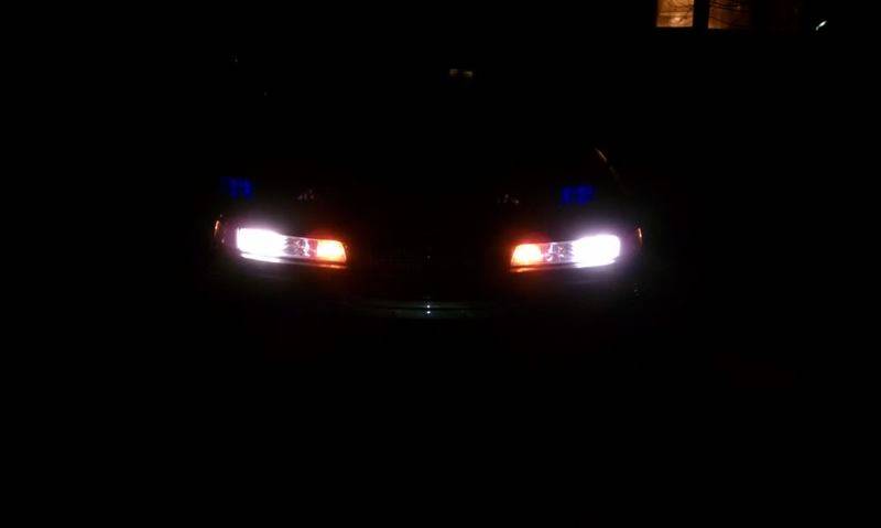

Doug, just wondering what "kelvin" was used in that HID install. They appear to look like 4300K because they kinda have a halogen look. I was expecting to see something with a more whiter color. That is a nice looking install btw.
I don't think he meant to post that picture, those are the high beams, and in one of his first pictures of the thread it shows he used just regular 9005 sylvania halogens in the high beam socket..those things definetly look yellow compared to 4300K..this is mine with 4300K hids..much whiter that DLFs picture
Yeah, that is much whiter so I guess in the pic, we're looking at a halogen lol. I guess there is a reason why a pic of the low beam wasn't taken or posted.
Yup, I'm a sleep deprived idiot, that wasn't the right pic. :rolleyes:
As far as the bulb temp, I don't know, maybe Joe will post it. :confused:
