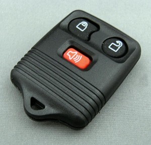

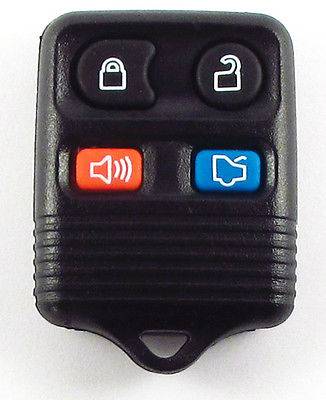

so the ones that came with the car should look like this
does your look like this or is it completely different
if different, does it have a brand name or logo? (maybe on the back or other number)

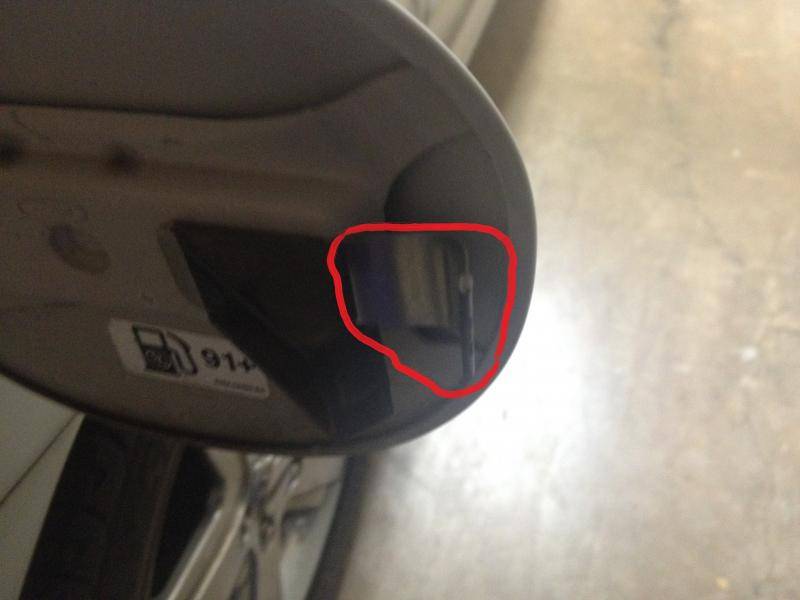

Circled in red is the metal spring clip that pushes the door open.

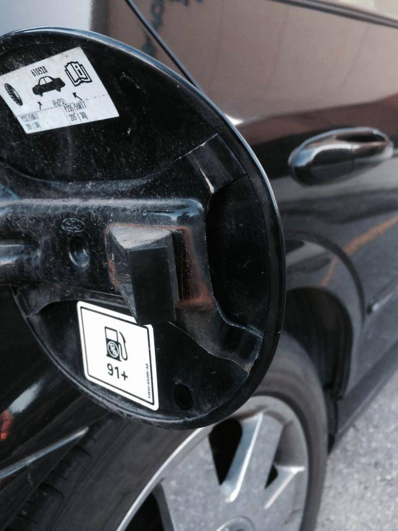

First off BigRigLS, would you like it if I ever said to you, "What's wrong? Are you too stupid to know that You in English can mean one person or a group of people?" I was not referring to you or the person that got the photograph. photo1.jpg
Second, this photo is what I have behind the gas door. I see the black thing that is labelled as 28608. I see a rectangle of metal under that - which seems to be the part labelled as 9A095 and the door 405A26. Like most IKEA furniture, that diagram is not clear enough. If the little rectangle is supposed to represent a spring, well then I think whoever drew the diagram is the one with the brain disorder. Until the photo, thankfully provided provided by someone with brains and manners enough to do what no one else here did, I did not get to see what was missing. Ignorant and insulting answers like #17, 25, oh and how about #29 which shows someone's got a problem with attention span, did nothing to increase the useful information in the thread.

VS.
Hmmmm ?!?!?! ... I give, why can't you see what's different in these two pics?
Also take a look at part# 405A24, it's the little spring far deep inside behind the door arm lever that makes it pop forward.

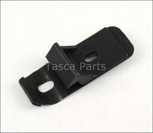

Call out item: 405A24 // Door Latch Spring Part# E83Z-54405A24-A
(it's the do-hickey that actually makes the door pop out after the latch and lock has released it, this is broke and why you are prying it open after the lock let go of the latch(which you also appear to be missing.))
GENUINE FORD OEM DOOR LATCH SPRING E83Z-54405A24-A / E83Z54405A24A

wow, looking at that picture, its even clearer to me what the problem is, you can even clearly see where there is a rusted jagged edge like something broke right off, but I guess with such a complicated part things can be so confusing.
also FYI part 9A095 is the octane sticker, its easy to tell that its not the spring in that diagram, because the spring has a different part number, and it shows where that part number is...

I would fully agree with that... when googling the model number that part replaced (4Z-5428608-A) it clearly matches the description of a spring (the part that is broke/missing), a retainer(aka the part that hold the door closed) and a washer (im sure this needs no further explanation). even looks like the part in the car with the exception of a little metal flap thats broke off as described months ago...
