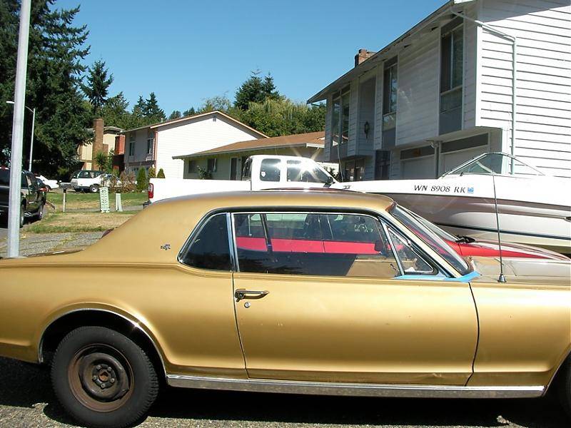

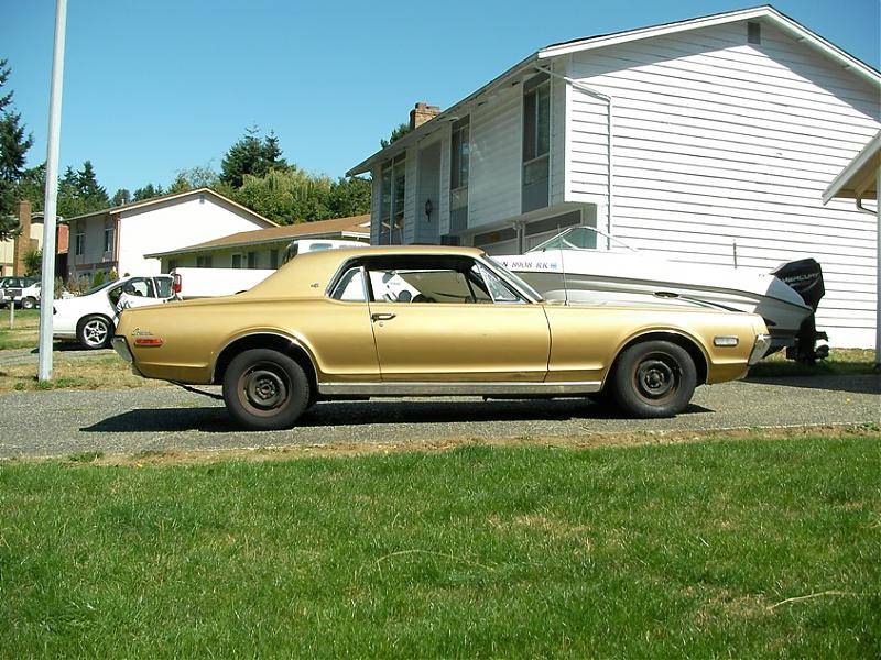

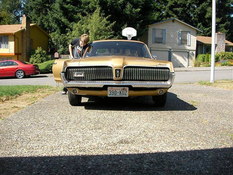

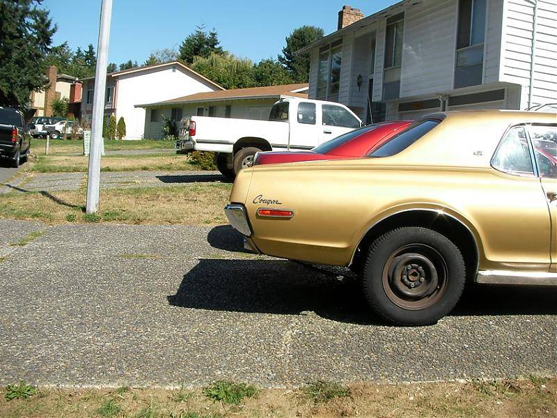

We re-modded the front and rear suspension...
It went up 3/4" in front, and down 1" in the rear...you guys will be amazed at my side - by - side shots of the Cougar, and the LS. Its virtually the same sized car. I will post them tonight.
As to rust areas, we will be chasing some of that this year, and yes we will tear everything down for paint. But, we put it all together, and to be honest, some of it has been done twice anyway...you know, "oops, gotta do that after all"...or..."oops, should have done that first"...you know the drill.

That Shelby Drop took it down ALOT !
I love the lower look though.

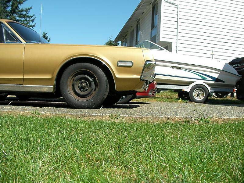

...and a full coil out of the new springs...it went down too far, and I have inserted some 3/4" insulators at the top...looks allot better. I also added 1" drop blocks to the rear and that went along way towards the right appearance...the pics will be up tomorrow.

Its hard to tell when the engine is out.
your going to have to wait untill the drive train is in to see were the suspension is going to wind up.
When the drive train is in...loosen everything then retighten to specs then you can set the ride height.
I would do that before painting the body, less chance if doing damage to new paint.

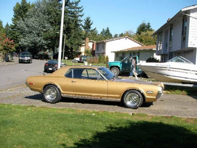

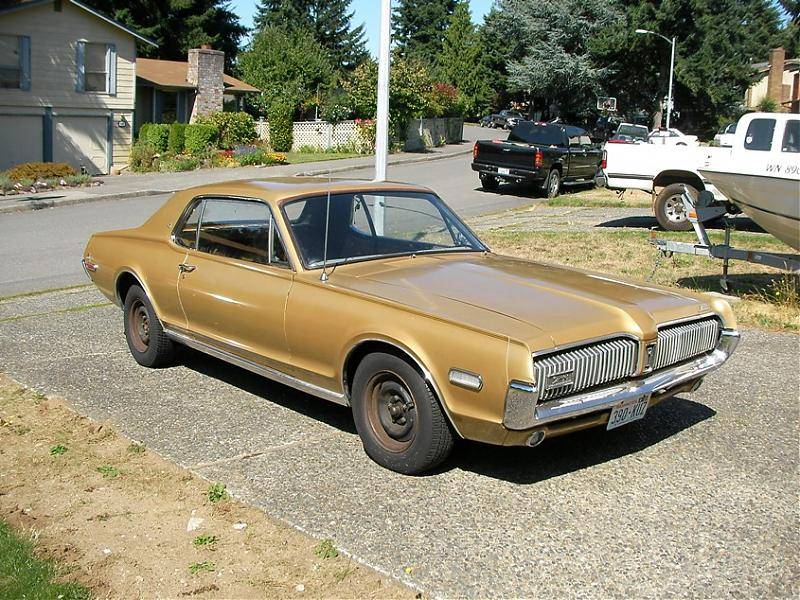

Here are the pics...

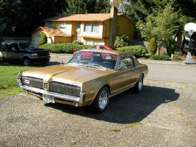

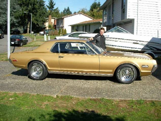

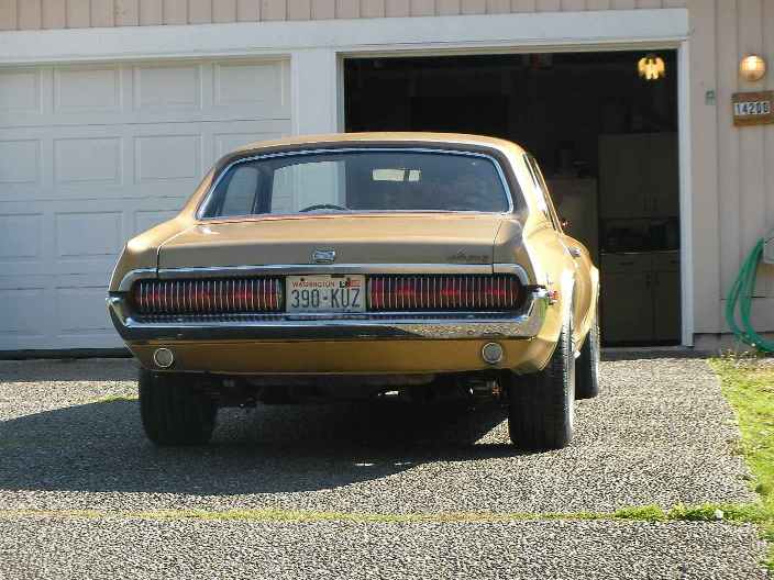

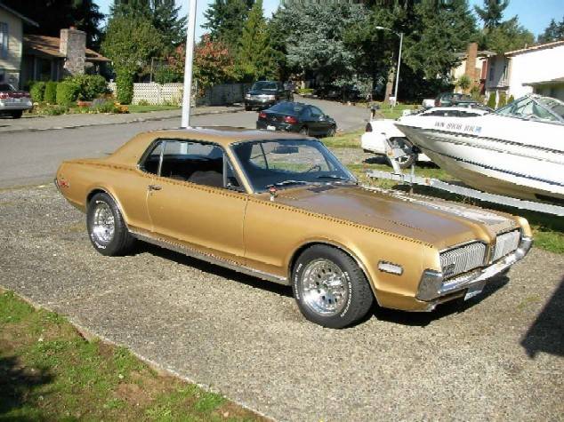

oops, its been several tomorrows, but here you go...the Cat is now a daily driver.
the things I've touched to get it on the road;
Tranny resealed
rear diff re-bearinged, and re-sealed
new drive shaft
new rear springs
new 1" drop blocks
new modified front springs
new brakes on all four corners
shelby drop mod, for front end
complete new/re-done interior(sans final upolstery)
new light switch
new drivers side grille(after sons best friend backed into it)
re-built the carb...man she runs nice now!
I am sure we will have lots of nights and weekends to keep this on the road!
