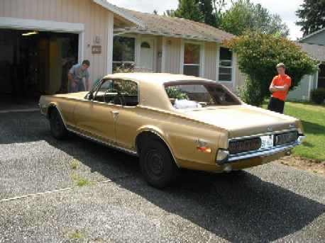

Anyway, here is our starting platform, which I drove home last night.
Enjoy...
Dam she looks good. Looks like a solid car. Some of the best memoris I have from growing up was helping my dad build his cuda's and duster's. You should get a lot of quality hours with your boys working on that.

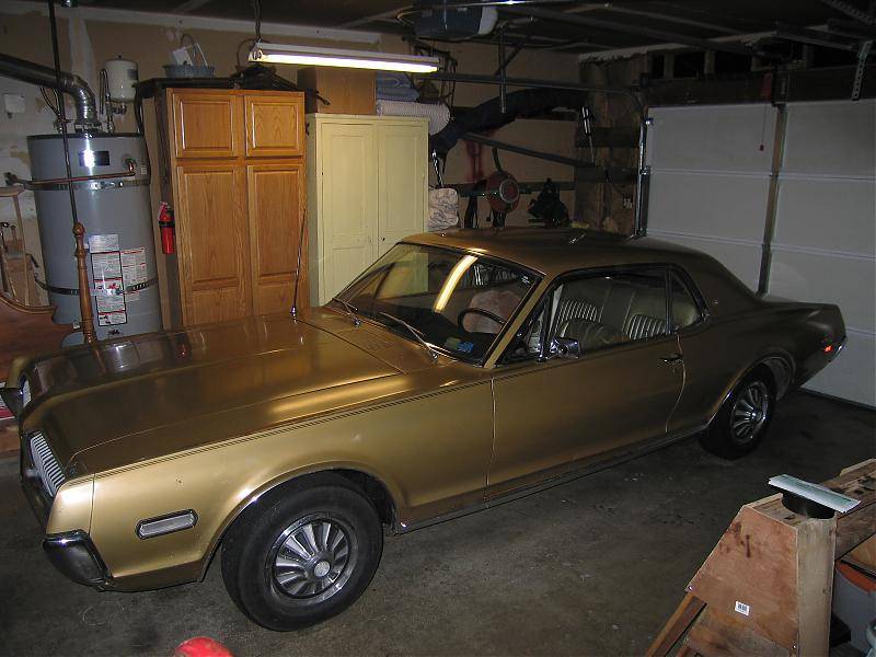

Thanks, she seams to be very solid...and the guy had 4 15 x 7 alloy rims, that went with it.

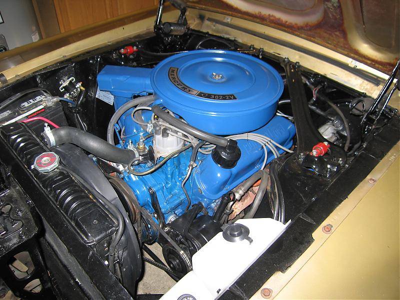

Also, when I inspected the car, I pulled the air filter housing off, and found a 4 barrel under it, not the 2v, the sticker shows!

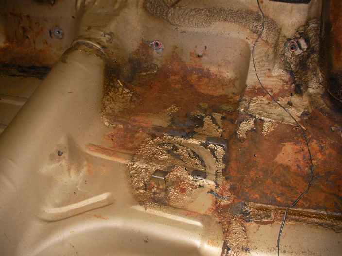

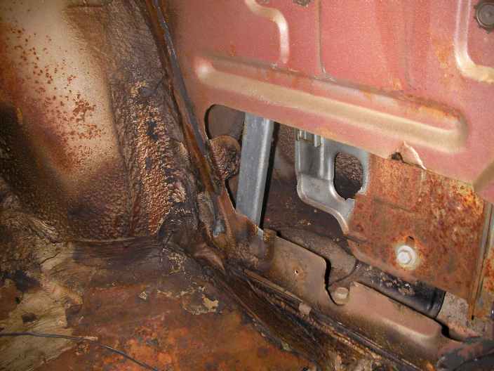

Look were the fenders bolt on for rust bubbles it will start were seams are....pull the trunk mat out and look at the rear quarters there is a compartment there by the rear frame rails if its been mudded you will see the bondo.
Floor boards solid ?
Car is from Washington right ? It should not have much for rust.

Thankfully, the rust is superficial, and there is no bondo, anywhere. This car has never been hit.

If it had the correct sticker for the car, it would say "4V".

2v=2 barrel carb 4v= 4 barrel carb....its the 60s my boy.

The engine compartment was redone when the motor was out of the car.
Is it a 302 ?

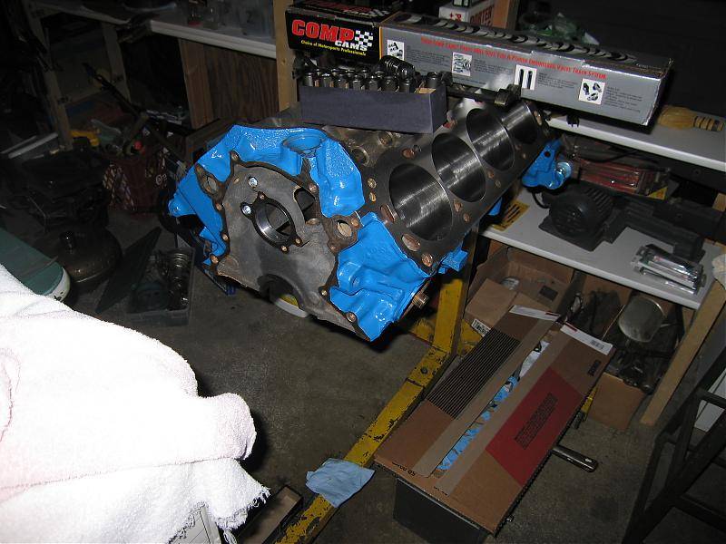

What motor is on the stand ?
If your going to change motors a stroked windsor is the ticket. :cool:

The motor in the car is in fact a 4V 302.
The motor on the stand is a mustang 5L, poked 40 over...now it is 308ci.

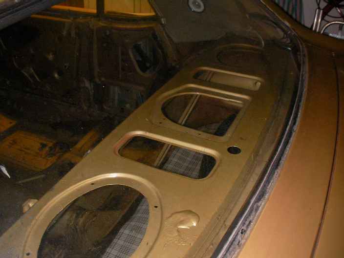

Update!
We have the rear end re-sealed, and bearinged.
The trans has been re-sealed...and looked brand new inside(only 127K on the clock)

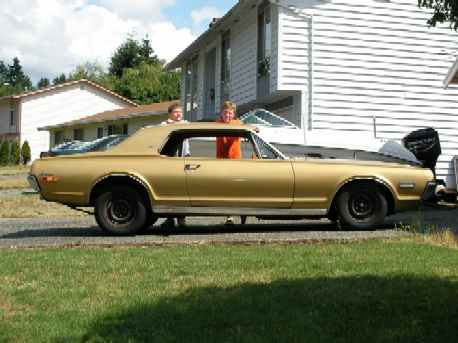

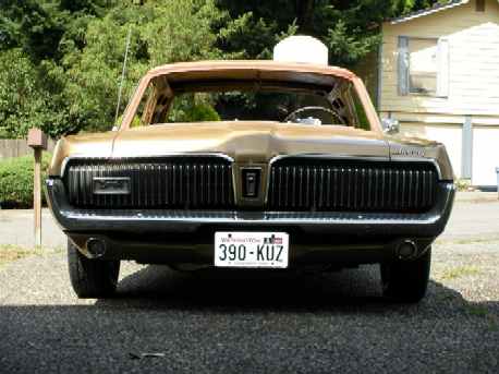

The rear springs, shocks, and u-bolts have all been updated, with a 1" drop.
The front has recieved the "Shelby Drop", with a coil out of the front springs...dropped too low, so I added a 3/4" insulator at the top.
Brakes have all been gone thru, and are ready for the street.
Rust has been chased as far as we are going to, at this point...only surface...only 2 small holes that got fixed.

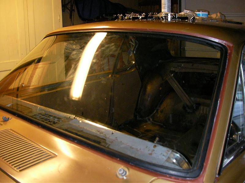

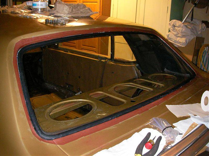

The glass is finally in, after we installed the new headliner. We are ready to finish the interior.
All new door, and belt line weather stripping in installed, and all windows have been adjusted for a weather tight fit, with NO rattling!
It will be back on its wheels and tires, this weekend, and by the Saturday after tomorrow, it will see its first road trip, since I drove it home.
We are very jazzed. We will chase whatever arises this school year, and then jump into it again, in the spring.
The new wheels will get new skins in the next 2 weeks, so it will be functionally, mechanically sound...but wont look like much, until next spring when we paint it.
Thats it for now...

I didn't see if you searched the rear trunk along the sides where the fenders connect to the floor on up to the fender wells, as this is a favorite spot for rust in these cars. Project looks great, I did one with my sons and they are now grown up and better for the experience.
That Shelby Drop took it down ALOT !
I love the lower look though.
