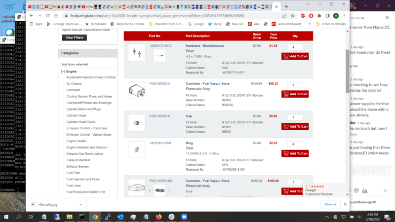

I just checked, none of this stuff is available any longer, and apparently, the LS fill tube is just a fill tube, so the vapor recovery system must tie in somewhere else on this car. Ah vapour recovery bits are still available!

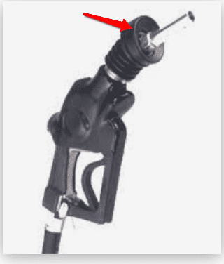

My 2006 does this with higher fill rate gas pumps. When it happens put two fingers between the lip of the cars fuel fill tube and the vapor seal on the gas pump hose to allow a bit of venting. Basically it puts the black plasic spring area back slightly and solves the problem.
