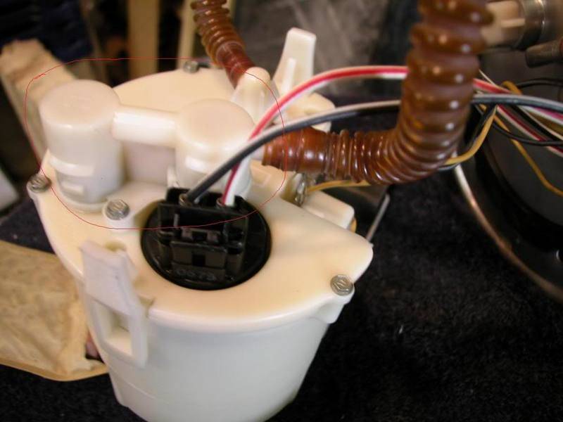

*note pic from tech article posted by OP*

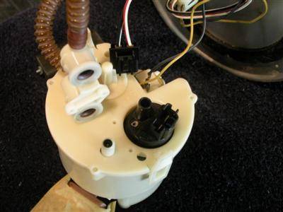

The pump is as far down as it goes. That plastic piece is different on mine. The one that is in the pic are maybe 1/4" or more taller than mine. Also if you look at the ones in the pic they have the plastic coming out the side on the middle. Mine dont have those either. Ill try posting a pic tomorrow.

This is what I have:

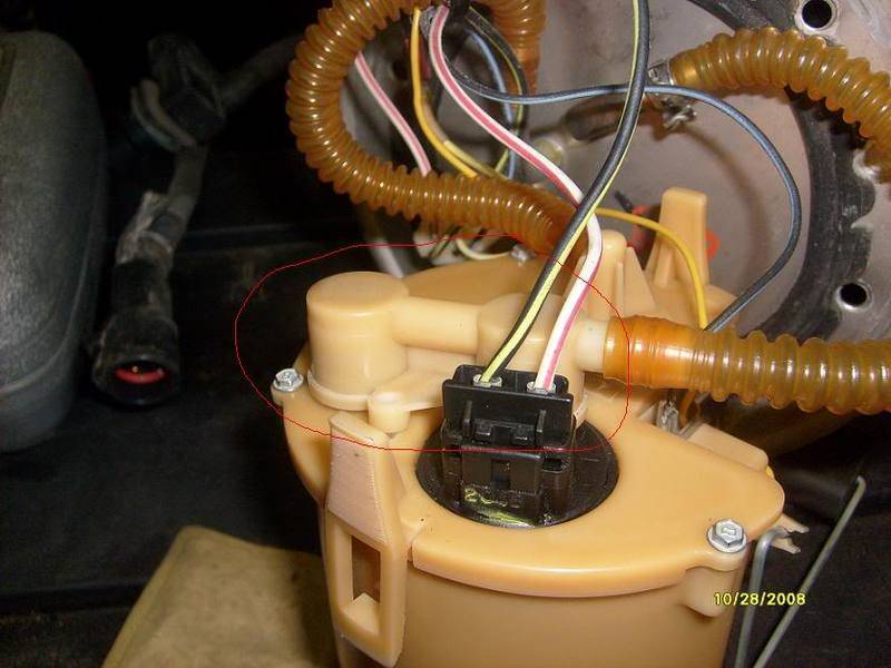

This is what I need:
Wow... I can't believe I didn't notice that...
Me either, the guy's talking about clearance problems, it's the first thing to be looking for. :p

Well, I didnt have a problem fitting the walbro into the basket... was quite easy actually. My problem is that the top piece is different in my assembly. I just wanna know if there is somewhere I can get that top piece separately. No mark viii's located in nearby junkyards:(
