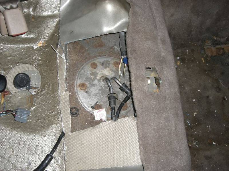

i'll post a pic for you. passenger side, right behind the bottom cushion's front hook. and no i didnt do this, this was a car i bought to part out.

20 minutes to drop a tank you must be a magician, just getting the exhaust out of the way first can be a nightmare specially if the exhaust bolts are rusted, and cutting a hole that small in the floor wont do anything to the stiffness of the car what so ever, unibody or not, i'm not saying its the way to do it, i wouldnt cut a hole in my own car, but it wont hurt the car if you choose to do it that way, just be careful not to cut into the tank. and charlie to answer your question that is a picture of a 98, 97 and 98 have a sending unit much like a fuel cell in a race car, the sending unit is seperate from the fuel pump thats why there is no ring, its bolted onto the top of the tank, 93-96 have a sending unit and pump as one assembly and that is held in with the ring. i have taken apart more mark VIII's than probably anyone on here and it takes me 20 minutes to jack the car up and get all my tools ready to do a job like that, it is no 20 minute job.

i would seam seal it and rivet, i would seal it though, the picture i showed you that car had no patch over it, i removed the seat and the picture was exactly how i saw it, and the seat foam was loaded with black mold and the seat was wet. deff seal it, even if its silicone, i prefer seam sealer though, you can get it at the local auto parts store in a caulking tube, stuff is great, same crap they use from the factory.

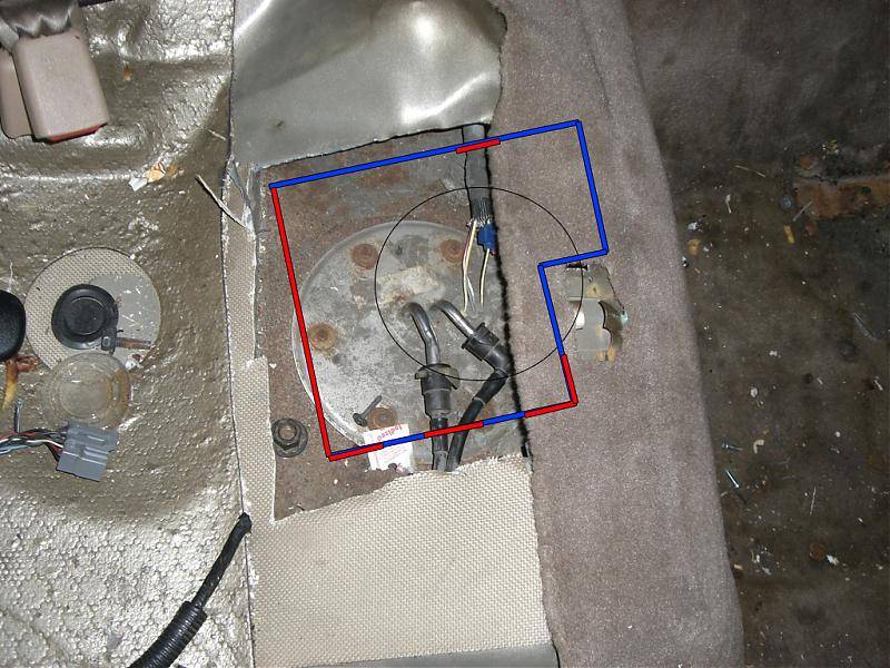

but i made some marks on the pic that was already posted to help aid others planing on taking the same route.
since the pic is a gen 2 its a little different, so I put the circle aproxamatly where the pump is on the gen ones. I cut the hole (marked in blue) with a air hack saw. and cut the blade really short. be very very careful while doing this you do not want the blade to brake threw the back side of the floor where i marked in red there is less then a 16th of an inch between the floor and the gas tank. be careful and take your time.
when cutting the hole do not cut out the seat clip. it takes a little finness to get the pump around it but its possible.
now for the patch.
its much easyer to reuse the part you cut out. since the floor is so close in some parts its not a simple as drilling and riviting. and of course the pice only fits in the hole. it dosnt cover it.
so go to a local hardware or car auto store and find some inch wide strips of steel. either 18 or 20 guage. clean the parch panel. (this can be difficult)
now here is the important part. on the pannel where I marked the compleat side red. you want to weld a strip across that side on the underside of your patch leaving about half of the strip hanging off. now you want to frame teh rest of your patch pannel but welding the rest of the strips on the top side (this is very important). now clean up and paint your pice top and bottom (any spray paint will do) you will never see it you just want to keep it from rusting.
your patch should be a perfiect fit. the side marked with red your framing strip will slide under the floor and the rest of the frame will sit on top of the floor. it should fit snug as long as you didnt warp it while welding.
use a seam sealer available at any auto parts store run a bead around your frame put your patch in place and drill hole and riving to hold in place MAKE SURE YOU MARK ANY PLACES THAT THE TANK OR LINES ARE TO CLOSE TO ALOW FOR DRILLING AND RIVITING. and obviosly dont drill or rivit there. put a little more seam sealer around the edge of your patch to keep water out. let it dry and ad a coat of robber based rocker guard (seals everything up nice.) let dry again and put the seat back in.
