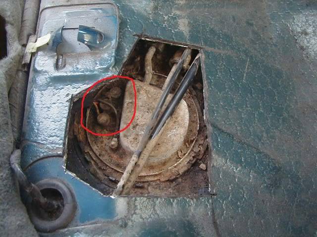

The fuel pump on my 93 died. Ordered a Walbro replacement and it arrived today.
Because my exhaust guy welded the exhaust all the way up to the front of the car, I had to get at the pump thru the passenger compartment, rather than drop the tank. I cut a hole similar to the one in this picture:
So, how do I disconnect the wires circled in red?
you don't. not there anyway. there is a big connector for everything farther down those wires.

Fuel tank power connector
Those wires are the electrical feed to fuel pump and checking for power delivered there to the fuel pump is a good place to check with multimeter for voltage supply,(another good place to check is in the trunk at the inertia cut off switch at its connector.) When key is turned on for about three seconds pump is priming fuel rail.
Those wires in the red circle lead forward of the fuel tank towards the rear drive shaft u-joint area to a connector.
The fuel tank assembler may have pinched the wires between the plastic fuel tank and the metal tank strap shroud and loosening the tank strap bolts and supporting fuel tank may be required to also allow enough room to feed the electrical connector back to the red circle. Of course this means having the car up on jack stands to get under fuel tank and a third jack and a four foot 4x6 to help support the durable plastic fuel tank still to loosen the fuel tank strap bolts. You will need to take notice the corner notch on top/forward fuel tank near the red circle where to feed the wire connector, its a tight fit don't force the connector though this area.
Because of this wire connector in the red circle this defeats the "hole" idea. Because a socket still must be placed on tank strap bolts to allow enough room to feed connector to red circle or the wire has been pinched by the fuel tank assembler.
