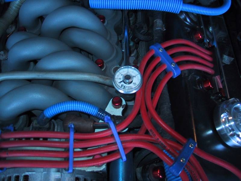

That is what I have.
I did not use the included fittings. I got a 1/16" male pipe X 1/8" female pipe adaptor and replaced the schrader valve, then installed the gauge directly into the adaptor.
